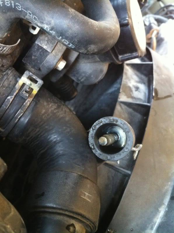

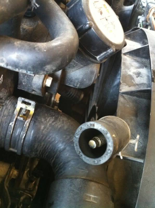

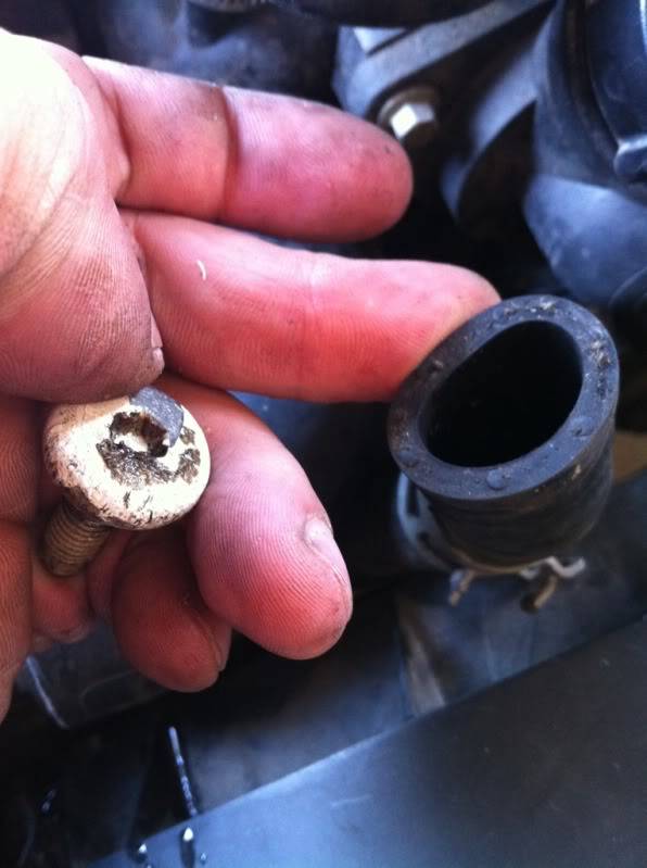

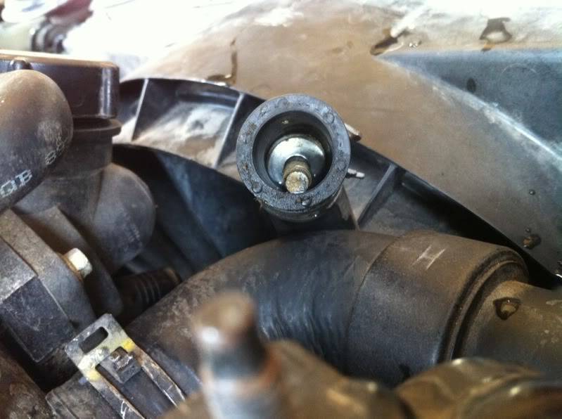

Ok, So decided to look the cooling system over once more today and see if I had any luck. My A/C works great, but I still had no heat. Yesterday, I drained the old stuff out and decided to fill it with just water and run it like that for a day and then see what kinda crud would come out in a day with another drain.
Today, I drained the system once more. Then, I started with the degas bottle to make sure there was no blockage there, since when I drained the system, it was the only thing that didnt drain. I removed it and all the hoses attached and made sure there was free flow for the coolant. I used some regulated low pressure air and listened as the air made its way. Then I went to the engine fill port and checked those hoses, I pulled the lower hose off which runs to the aux pump and guess what I found?! A huge bolt shoved into that hose! I'm guessing thats how the mechanic from before had bypassed the DCCV, either that or somebody was trying to make some easy cash... Pictures below.. Now my heaters blowing flaming hot air! Thanx all for your input, Ive learned alot about this cooling sytem from this incident.
There was another thread where the same thing had happened but it was a wooden plug instead of a blot.
seems like this is a common scam.
