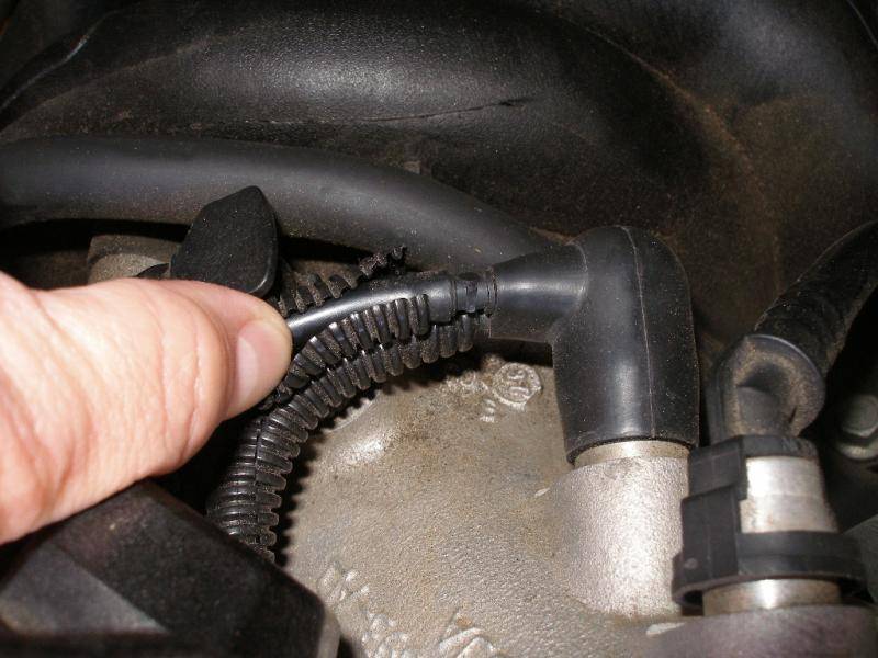

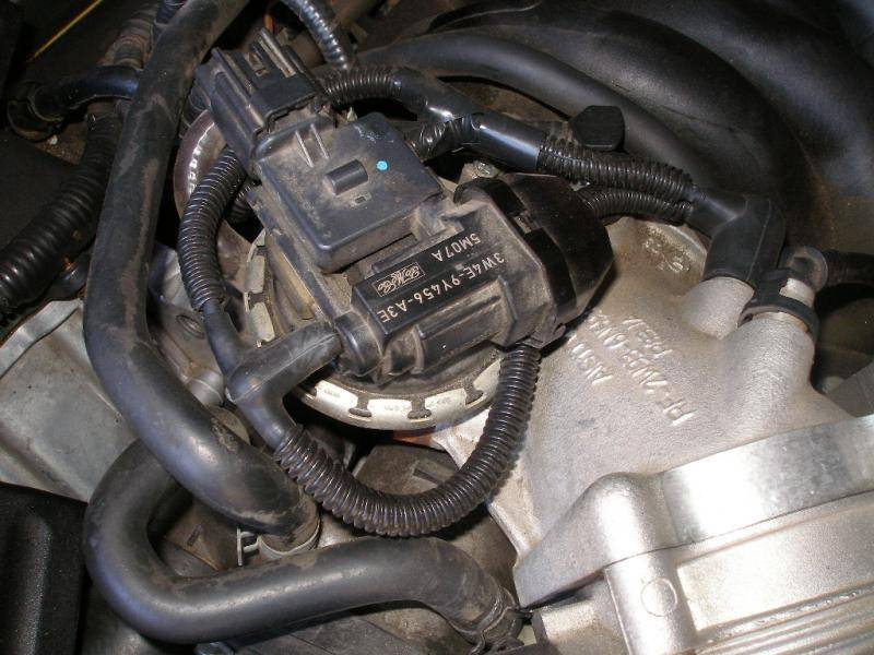

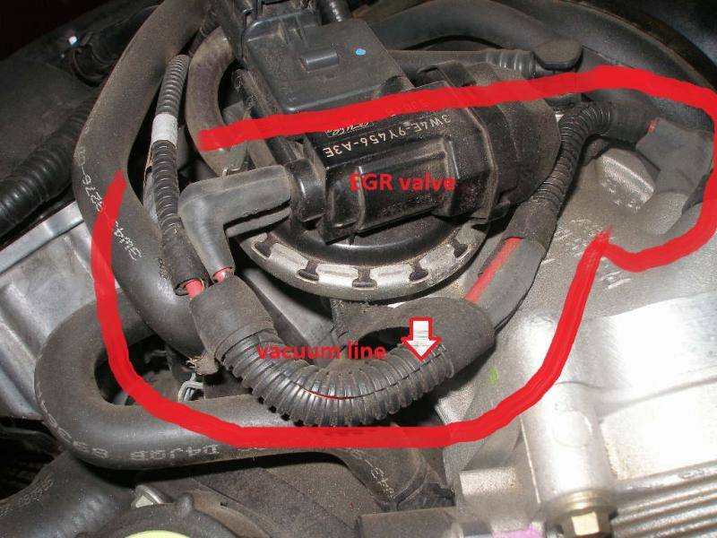

noticed a faint solid continuous whistle under the hood, i checked the hoses and couldnt pinpoint it. sounded close to the egr, just wondering if this is normal, or should i get a tech to check it out?

Sounds like at least one of those hard vacuum lines near the egr valve is broken or cracked. I broke one or two cleaning the TB just by moving the harness and got a CEL. If no CEL I would assume just a crack. The harness isn't available but with some vacuum hose and fittings you can make your own. I salvaged the old connectors, which made life a little easier.

Ahh big thanks guys. Yess i will check those egr lines. Fill the tank asap and if thats really true about the warm up i'll take that advice. Sounds about right im just stuck on traditional carb setups :p
Will report back with updates and findings.
