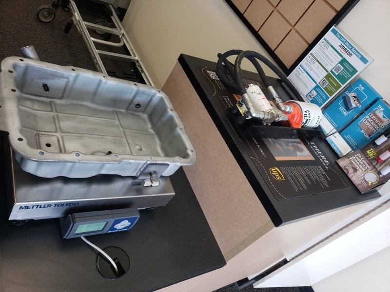

Try adding a dip stick hose to the pan with a quick drain 1/8 npt plug. The pump filter setup is to mount on the ps rack bolts under the rear engine. A Lokar AOD 36" dip stick kit fits well. The dip stick receptacle is 0.8 drill in thick wall pipe. I sent the pan to Pat Garrett at LevelTen Transmissions for his approval before he sent the "Beast" 5R55S with it installed back to me.
