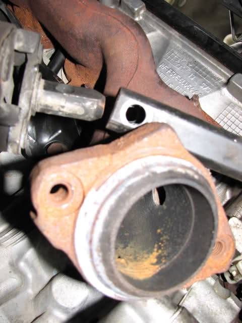

everyone says these fit, but no-one has ever posted pics as proof. well here is some pics, and guesse what? they really don't "just bolt right on." everyone also states "you might need a slimer steering joint." well, as you can see, there is PLENTY of joint clearence, ........but, the shaft itself is completly in the way, needs to be moved almost an inch to the side to be able to line up to the joint. looks like i will just hack off the cats off the stock manis, because i will not pay $800 for kooks.
You need to modify the steering shaft...
I thought it was pretty common knowledge that they bolt on, but you need to modify the steering shaft to make them work.
Every time I mention the manifolds, I mention the shaft needs modification.
Flaming river makes the stuff you need. I think one u-joint and one section of shaft.
I dont have the details as I did my shaft differently and used more parts. Turned out I went over-kill.
but just a new joint and a small peice of shaft isnt going to give you the clearence you need. the shaft itself needs to move about an inch over. you would have to do something like this to make it work: http://members.tccoa.com/392bird/birdworka1.htm
That is what I did. I forget who, Jeremi or Jamie maybe, someone, found a more cost effective way.
I know the factory joint is removed. I think a new shaft is added from the steering wheel down, elongating it from that end maybe. That puts the shaft past the manifold where you then install the new, smaller u-joint. I cant tell from the pics.

everything i read, the joint itself is where the clearence problem is, but there is plenty of room around the joint. if you have a pic of how you did that double joint, i would love to see it. but with a joint only on the rack, i just don't see how its possible to do without putting in a second joint.
I haven't done this conversion yet, but, with a welder and some square stock, a drill press, box tube, and a regular joint, it would go together, no?
