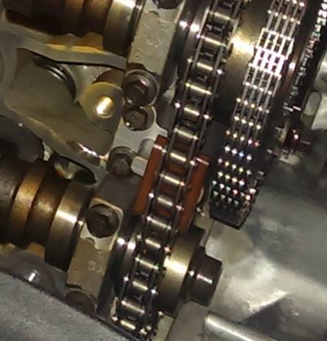

Also, I managed to find this picture I took almost exactly 7 years ago when I replaced the valve cover gaskets (the first time):
It looks to me like it has the metal housing of the upgraded tensioner but would appreciate confirmation from anyone who has more experience with this.
The reason I'm asking is that I'm about to have to replace the VCGs again (oil everywhere) and would use the opportunity to replace the timing chain tensioners if they're the problematic ones. If they're already the metal ones, I'm inclined to leave them alone.
