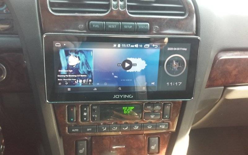

I installed a Joying widescreen unit in mine with a bunch of accessory options. I love it but it does have some little issues that had to be worked around.
One of my biggest gripes with it, and actually all Android head units from what I understand, is they all hobble the Bluetooth stack so it only allows a couple things like a phone & OBD. And most of the time they try to make it so you can only use the BT accessories they sell.

That bites, Duke. How much ram and space did you get on your unit? Mine's fast as hell. It's running Android 8.1 with 4g ram and 64g space.
Did you get your steering wheel hooked up? Mine was a little bit of a bitch but I got it working though the unit won't recognize long presses. I think I'll end up getting iDataLink's Maestro to remedy that problem. It really sucks though that I can't connect whatever BT device I want either. Tried connecting my Logitech keyboard and it sees it but it won't connect to it. I'm over on xda-developers Android Head Unit section of their forums and it looks like there are some workarounds. Mainly rooting. Not sure if I'm familiar or comfortable enough with this thing yet to do that.

To start with, Linc, they aren't tablets. They are dedicated Android Multimedia/Nav head units designed specifically for cars. The problem with using a tablet is you can't get the same functionality as you can with a dedicated head unit. Such as an AM/FM radio with RDS, backup cams, front dvr dash cams, tire pressure monitoring systems, built-in amplifiers with digital signal processing, SPDIF out, sub out, line level out, etc, etc. The down side with a dedicated unit is most makers tend to try and limit Android's functionality and customizing ability. BUT there are work arounds for that. On the site xda-developers.com they have a forum section just for those type of things. There are many very knowledgeable Android hackers there that know how to make most things work the way you want and if no one does odds are someone is working on it.
I agree with you on the name of my unit. I plan on finding a Lincoln gel badge or something to cover that with.
This is where I got mine from...
Joying 8.8 Inch Single Din Android Auto Carplay Car Radio Head Unit Support 4G Internet
You can also find Android head units on Amazon and eBay from many different manufacturers.
A few of the most functional (relatively) top brands are Joying, XTRONS, ATOTO, Dasaita .....
Happy hunting. Let us know what you decide to go with. :)
What Luna said. And my unit does not actually have a "brand". But it does have a nice graduated curve. I plan on modifying my message center button location and frenching it in to the dash. But as far as quality...if I were to do this again I would go for a more $$ higher quality unit
