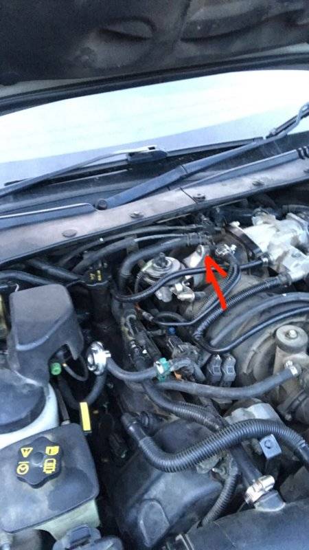

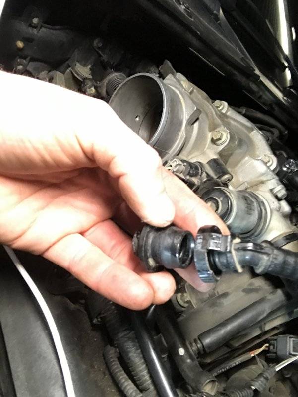

Here is a picture of what vacuum lines I replaced:

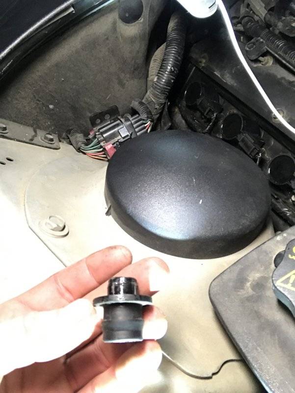

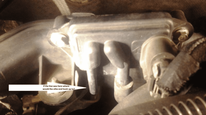

And here is a picture of the plastic tube that I broke off (used some epoxy to put it back on for now). Found this picture on the internet but the arrow is pointing at the piece that broke off in the hose.
This makes it a lot easier to locate the exact source of the hissing.
Those two vacuum lines connect into the two metal vacuum lines a little below the EGR Pressure Feedback Sensor...do you have access to a decent code reader or you can run down to Auto Parts Store and have them hook up there’s to see what’s on the PCM for codes? O’ Reilly’s has a Westinghouse Propane Torch for like $25 you could always purchase this torch and run the Propane over the intake if you haven’t already and see if your idle changes at all ...

Found it. I already replaced that hose yesterday though. Think I’ll order a new one of these:

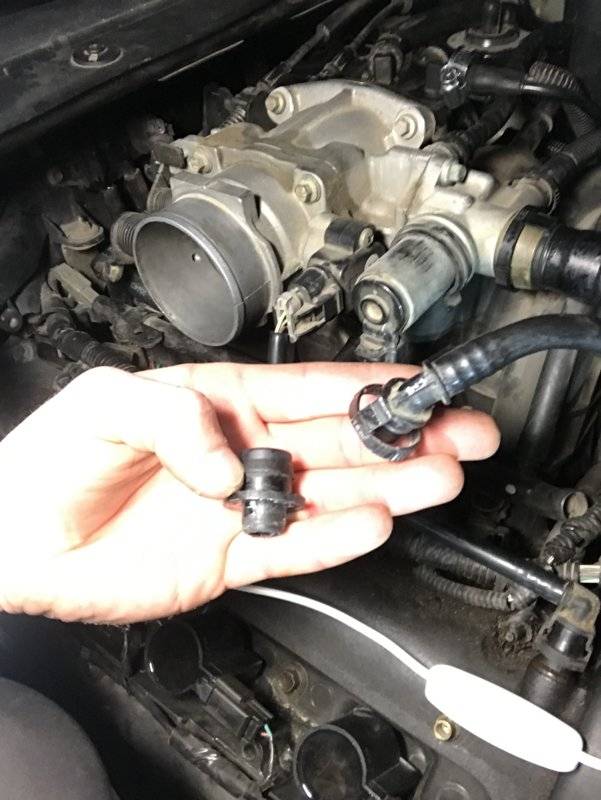

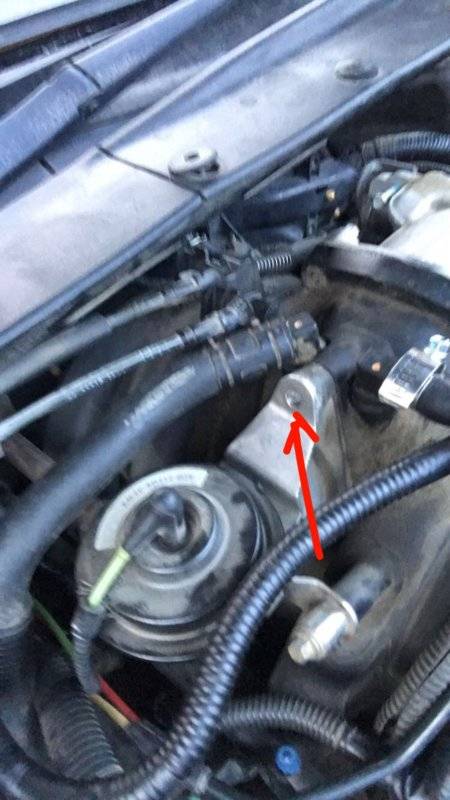

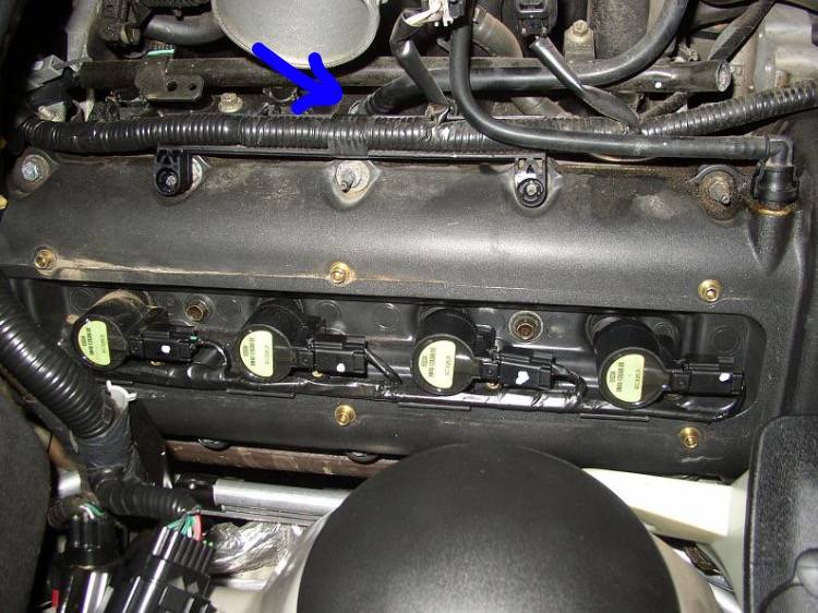

The hose I said I already replaced (post #7), well the sound was coming from on the passenger side where the hose goes into the top of the intake manifold (Bottom picture, blue arrow). Apparently there is a plastic adapter that goes between the hose and the manifold. I’ll post a picture of it tomorrow but it’s about an inch long and plugs into the intake manifold on one side and the hose clip fits over the other side. The part that goes into the IM is loose and wont stay in place and when I push it tight the hissing is gone.
Any recommendations on what I should use to glue the adapter back in place so that the seal is tight?

On another note, does anyone know the size of the bolt that goes in this hole? It looks like I’m missing one..
Here are the pictures I was supposed to post of the adapter thing. I put a ring of jbweld marine putty around the lip and smushed it down into its hole.
