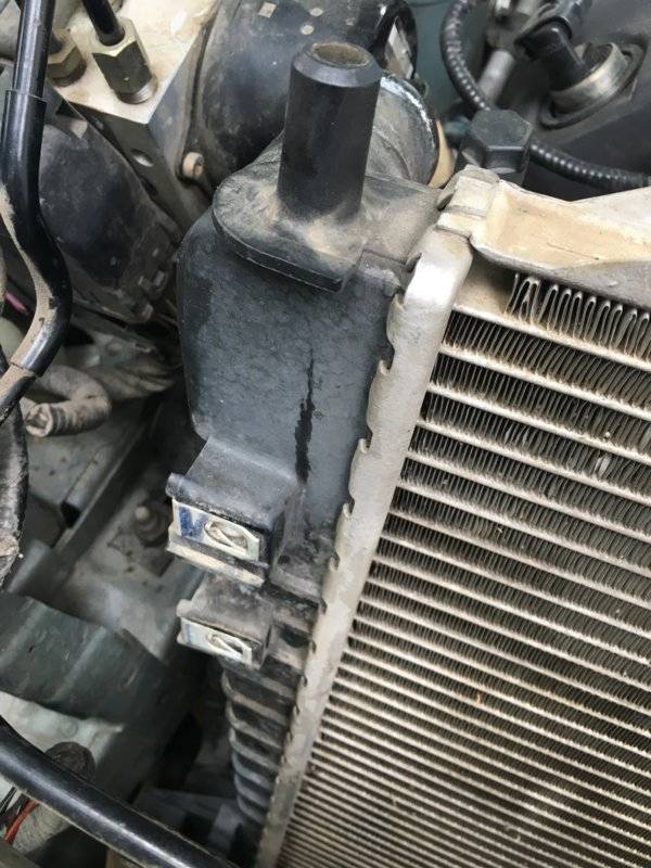

      My radiator blew on my ‘03 at around 180k miles. I am doing an overhaul on my ‘06 and I will be replacing the radiator now because it’s a very common problem on these cars. The front top passenger side corner develops a vertical crack on these cars. My ‘06 has 125k miles and if I look through the grill, I can see where the radiator will eventually blow, just like the one on my ‘03.

      I will take a 2nd look at mine today. I am still trying to get over being overheated from yesterday... Was not exactly fun having to wait 2 hours for a tow truck in the direct sun light! When I checked around all around my radiator it looks pretty clean nothing looks cracked or broken so I think I am good on the Radiator for now. But thanks will take a 2nd look at mine cause of you pointing out your weak spot on yours. But I did at least order that awesome crowfoot wrench so I can change out that thermostat and housing !
      Edit: I checked but I don't have pics and all seemed to look fine on the radiator area. But there was a lot of leafs and trash that had got between the radiator. So I cleaned it up the best I could do since my pressure washer just took a crap on me today. Will fix that and clean it up really good before I get her back on the road.

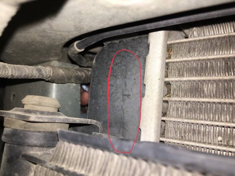

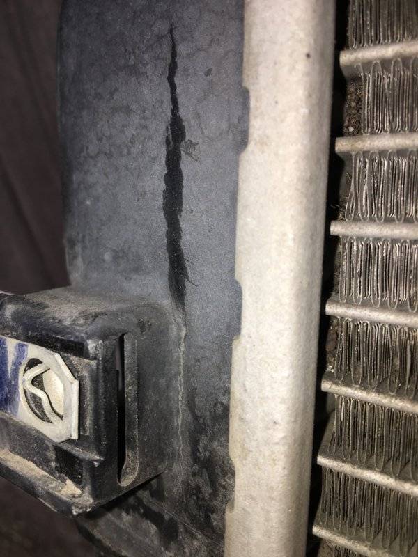

      I had to make another post cause I am very blind for some reason (I need glasses) Think I figured out my leak

      That picture I posted earlier was taken last week. I’m now changing it and glad I am. Although it wasn’t leaking, it is definitely about to start. Mind you, I drained the system out last week and haven’t driven it since.

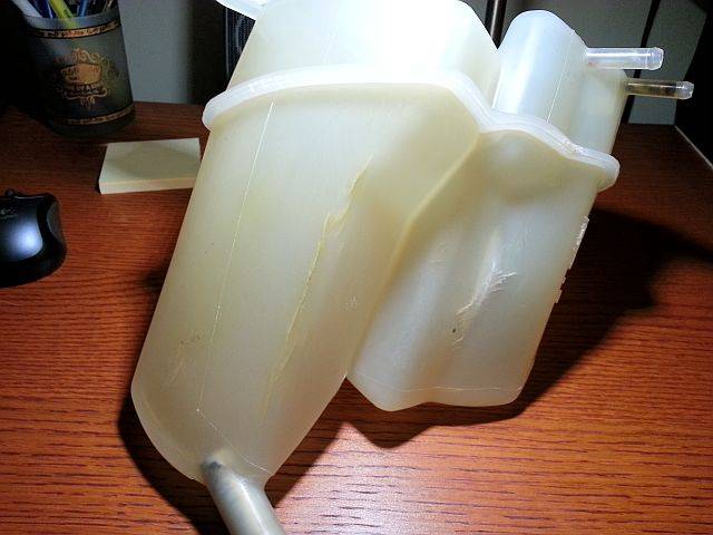

      Re&Re - OEM Degas Bottle - GEN 1 V8
      They all end up with micro-cracks on the back side of the bottle due to excessive heat cycling over time. It's hidden up against the firewall.
      Often Members continue to report that they don't see anything wrong with the Degas Bottle, that they can not see any cracks and that it must be fine ... not the failing component.
      Once the bottle is out ... cracks on the back side can be seen.
      Clear sign that the degas bottle is done would be when a solid stream of hot coolant is pissing down directly behind the drivers front wheel.
      While it gets to that stage it already has the micro-cracks in it and as already noted, during heat cycling and cool down, it will let air in and out. Introducing air into the closed-looped system and thus begins to radically overheat. Re-bleeding it over and over again yields little results as it will never properly bleed to the point that it will maintain it's required pressure within the system.
      :: Typically 10yr/100K mi, these LS cooling systems need a complete rebuild with OEM parts ::
      ~ I'd replace that aging 1st GEN "Auxiliary Coolant Flow Pump" and "Dual Climate Control Valve" as well if I was you (while entire system is open).

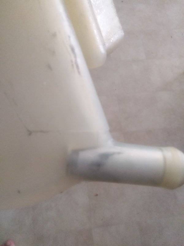

            Well I am not entirely sure my tank cracked itself I think the issue was the inside metal tube it for sure is broke and the tube itself looks stretched out. The Tank had been replaced in the last few years with a OEM motorcraft bottle as per the carfax (Was at a Lincoln Dealer) just honestly looked like crap work I mean most of the plastic rivets that hold everything down on the top were in bad shape like they had been pried up on. This is the reason I am ordering the hose itself for the Tank when I order the Jaguar Uro Bottle.
            I am replacing all that plastic though it looked aged for sure. Can you link me to the correct Coolant Outlet Pipe please? I keep finding the wrong part I think so I wanted to be sure which part number that one was. I am not saying the dealer did this it could very have well been the last owner cause the tank had that broken tube maybe they had overheating and could not figure out why and pulled up on the tank that is almost what it looks like to me. The Clamp even looked chewed up a good bit. Being it is pressurized I am not risking using that old hose at all...
