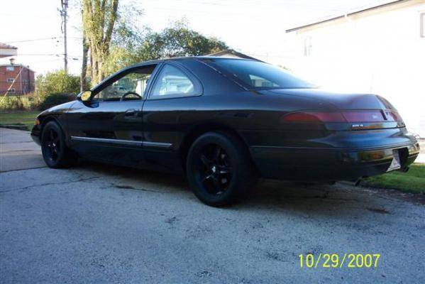

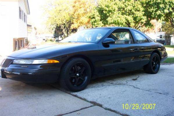

1995 Lincoln Mark VIII spray paint is awesome her name is rattlecan

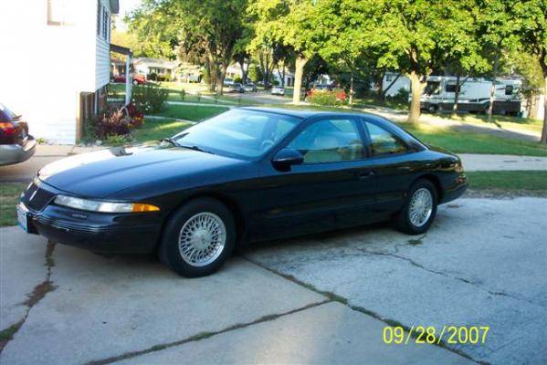

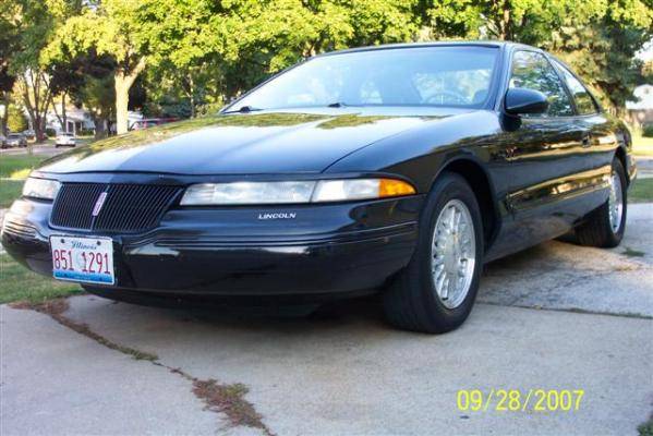

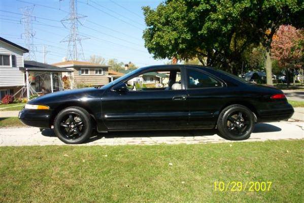

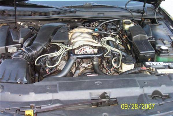

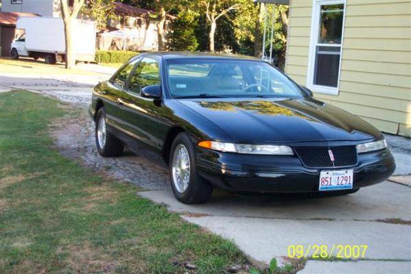

pretty stock for now, 88000 on the clock. had severe clear coat peeling -roof ,trunk, upper quarter, front and rear bumbers.drivers rocker rusted a good 2 feet just started to bring her back .so far a lot of spray paint and filler on body. mech 02 sensors, egr tube ,dpfe,evr,swaybar and on and on.255/50/16 falken ze 512 in back and it will still light the tires up and bark it in 2 gear.so far the fastest mark i owned compared to the mark lll/mark vii that i had
prep surface,dupli color black paint and clear coat[can spray paint]roof,decklid,upper quarter,rockers bumpers and trim are done on mine this way
The grill and side trim i hit with 3m scuff pad and for the metal trim i sanded it with 80 grit then 180 for the paint to bite.
I used duplicolor black high build primer on the trim parts with a light scuff then followed by paint
