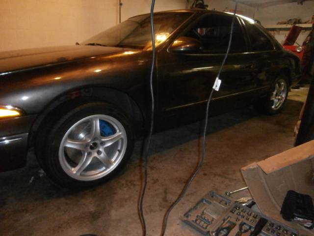

finished bleeding the brakes, then put the wheels on, lowered it, cranked down on the axle nuts w/ a 48'' steel pipe
i 'think' I may be buying some 1'' dropped springs before long
if you just put it on the ground, it should settle a little the first time you drive it.
looks good though.

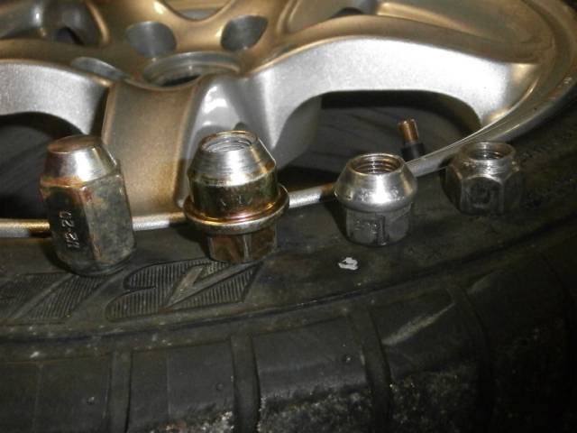

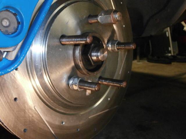

thx C, the front lug studs are too long for the nuts that came with these wheels. i guess I''ll have to 'double nut' em? put an open nut down tight, then the polished, trim lug nut on top....

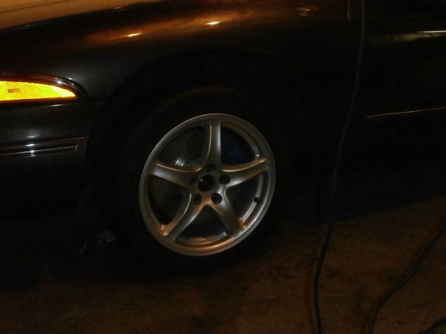

wheels are 30mm offset...245/45/17 tires, 5 rims on 5 mismatched performance treads
Trim studs down?
Or use the open lug nuts only, until you find a solution. Double lug nutted is going to look stupid.

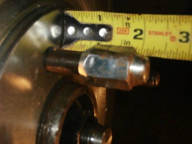

the rear lug stud lengths are fine, it's the fronts that are too long...the factory Mustang hub/bearing assemblies
I love those 98 Cobra wheels, my all time favorite OE mustang wheel. Need some better pics now.
Do the mustang studs have the first 1/4 inch of the stud with no threads like a mk8 stud? If so just trim it off.
Did you buy the right lug nuts cause mine fit fine
Over the mustang studs.
I bought the rims/tires, caps and nuts from the previous owner, he had em on a Fox Mousetang

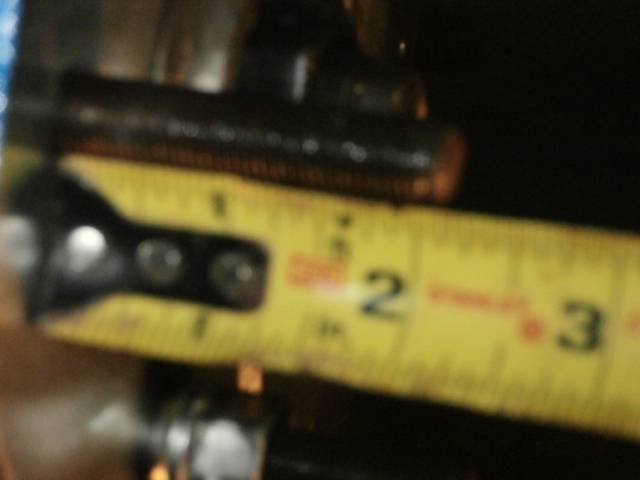

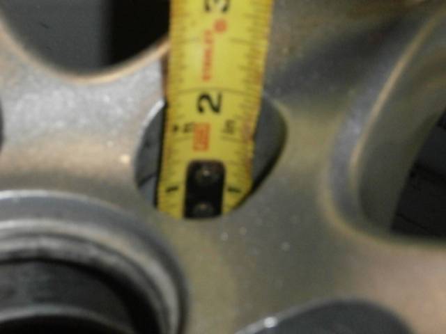

I'll look again after work tonight, and measure what's sticking out...I wonder if there's an aberration with the rotor depth- causing there to be more stud exposed...the way the studs are hidden in the wheels, i don't 'think' dbl-nutting would look bad or stand out

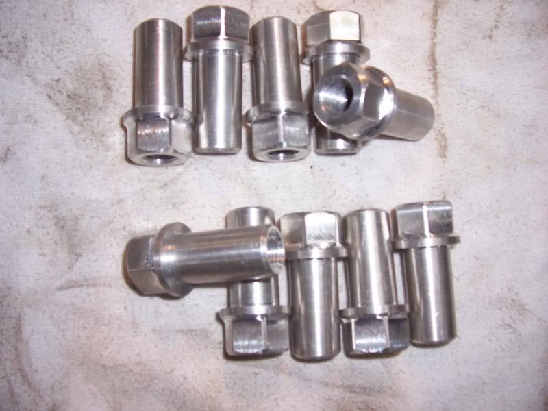

lug stud lengths etc., and the variety of nuts i bought with the rims
closed/finish-nut as far as it can go down
plenty of depth for dbl nut w/out sticking out past the recess?

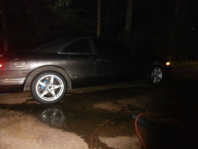

drove this car tonight,
first time in about a month or more.....way out of alignment, pulls to the right, none of the tires are real bad so I guess the swapped knuckles have me all cattywampus...it drove real straight and smooth before the swap
(I have NO IDEA why it looks like I'm sporting a 1'' lift kit now)
Those are not stock studs. Those are 2.5 inch racing studs that previous owner installed. These are the style lugs that are used on those studs.
solution = push em out, pull new ones in?
or I could have used the new hubs I ordered then had returned :facesjump
re; alignment, is there a specific brand/type of machine I should look for to get optimal results? I've been going to the local NTB b/c it's close, but ...well, they have disappointed repeatedly

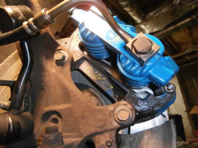

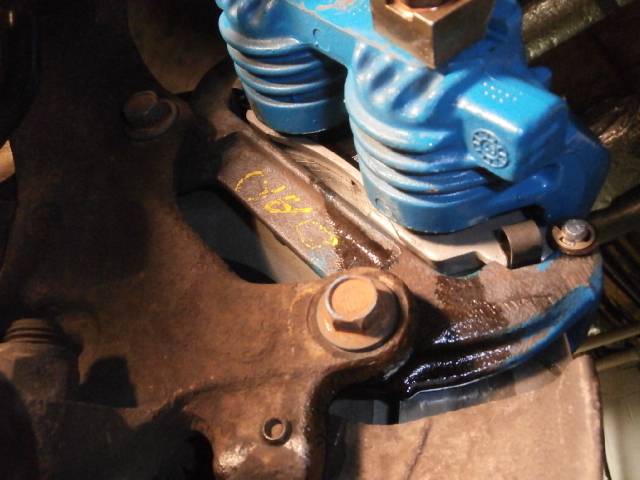

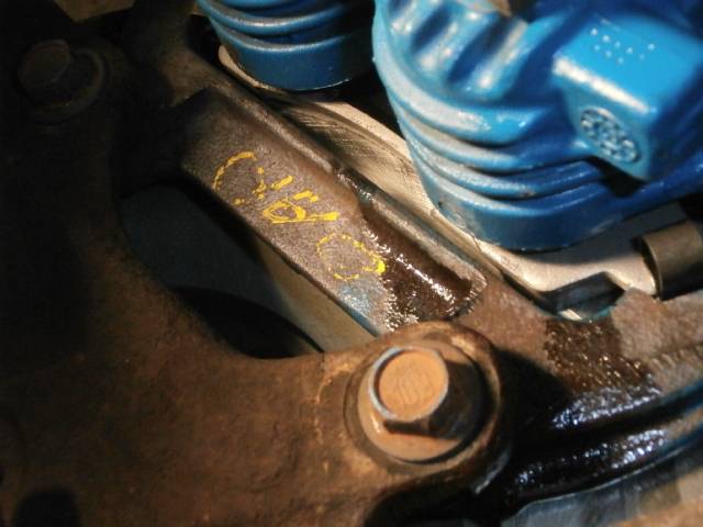

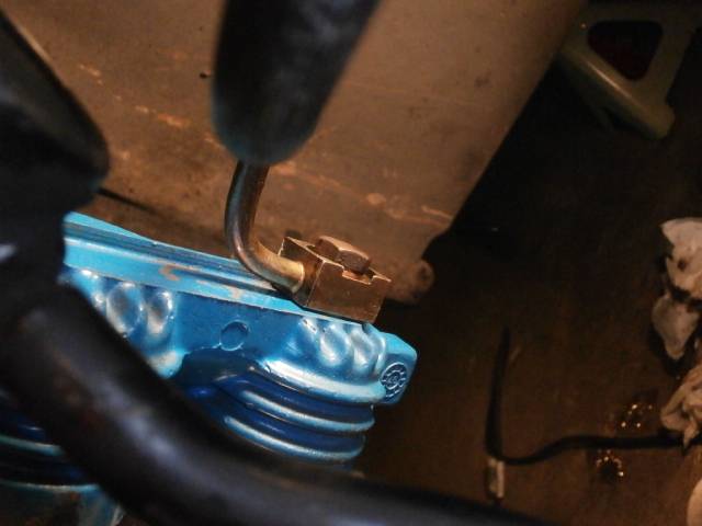

and.......a leak
pretty sure this only started leaking after i test drove it, maybe i pierced a piston dust boot when installing pads? (8 new copper washers around all 4 banjos, all 4 calipers rebuilt)
Fluid will not leak out if there are holes in dust boots. I work on cars all the time and boots are F'ed up and no leaking.
