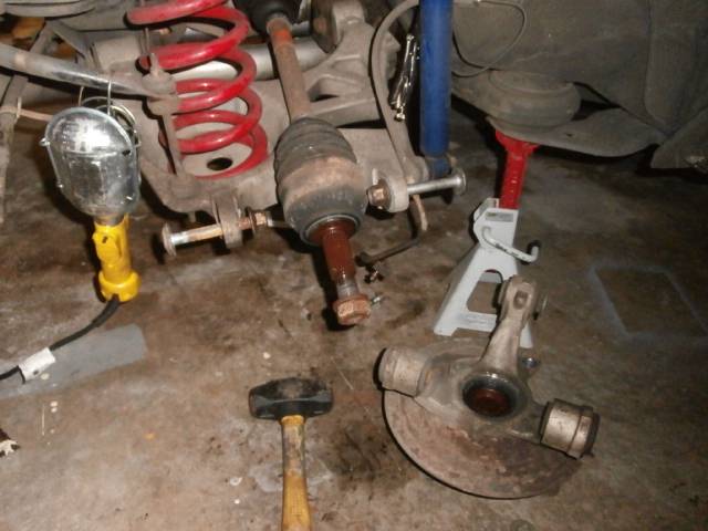

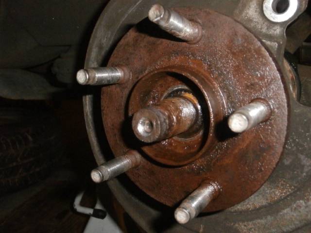

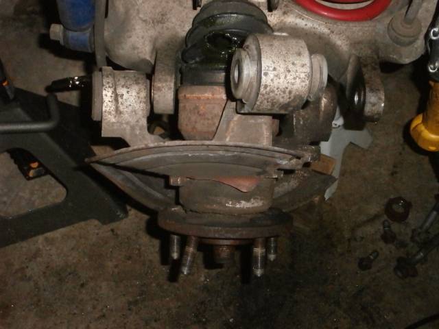

or, instead of paying someone to pull apart my rusted rear hub-axle(s)....find and buy used rear axles off a southern parts Mark (I'm in Georgia) or the auction site and combine them with the two knuckles I already plan to use...with the torn boot (and rusted to the hub, this one is essentially junk now
Are both sides frozen in? I always keep spare axles in my stock pile just in case. Yes you can buy used axles I bet for 35 dollars each and be done.

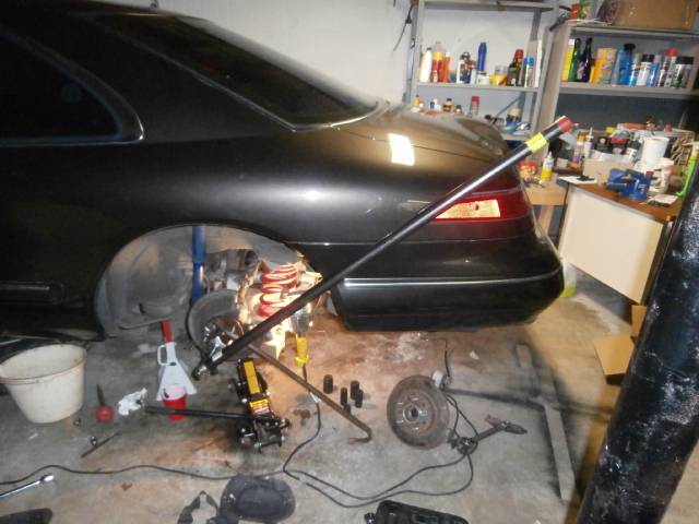

I would put a good bit of torque on the puller shaft and then smack the outer edge of the hub hard with a hammer a few times.
and this folks is why as a snow/rust belt resident every thru bolt and splined shaft gets a liberal coating of antiseize during assembly....
At this point I'd cut the head completely, punch it out the other side, and find a big press, a torch and strong arm it.

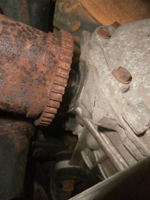

since I'm r/r the half shaft AND the knuckle, all I need to do now (for this driver's side) is remove the ABS sensor and pry the shaft out from he diff, yes?
I don't need to mess with pressing the outer spindle through the hub at this point. I'll set my sights on doing it RIGHT for the pass side
You don't touch the ABS sensor that is mounted to the pumkin and can stay. When your ready to pull spindle/axle just take pry bar and lever between pumkin and very end of CV shaft, one pry and they pop out like butter.
drvr side
pass side, easy peasy
do I need to temp plug the diff to avoid fluid loss
considering how rusted they are at the inboard end should I just replace both half axles with ones that have 179k and are from the south (less rust)?

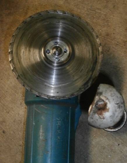

trying to push that frozen spindle through the hub just about pulled my shoulder out of socket so I gave up on that;
got back into it and trimmed the LCA bolt
now ready to r/r the half axles
no reservations about re-using that LCA bolt?
used axles w/ 180k for 70 and drive 40 miles, or new for 160 from O'R's...hmm
I love my lil skeeter grinder, just realized I've had it since about 1993...still kickin arse
I use the trimmed bolt in my car no problem going on 6 years.
