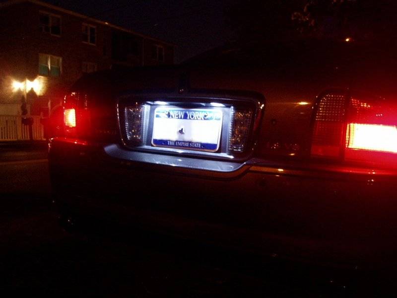

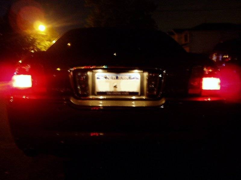

Here's a before and after comparison. These fuggers are BRIGHT! A little bluish tint to them, but I like 'em.
Excuse the unclear pics - my camera sucks ass at night.
I think so, too. Thanks again, Ken! And if you need pics for your site, feel free to use these.

Nice, I told you guys they look good. :)
