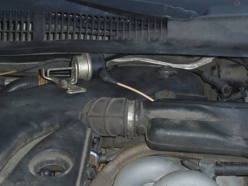

Did the Seafoam way back when this first started and no such luck. I picked up another 96" engine with 90k on it for dirt money but the engine swap is a bit more than I wish to do right now. So I took the bank 1 IMRC off to replace the bad one on my engine.
The one on my engine is shot. When I removed the vacuum line off of it I can pull up the lever and hold my finger over the port and it just drops back down while the one I removed from my engine holds as long as you have the port blocked. So the IMRC is shot that is on the car now. The plug I am talking about it on the back of the head and out of my reach from the top of the engine as far as I can see right now. I was thinking of lifting the car and seeing if I can get a view of it from below somehow?
I still don't know how I'm going to get the IMRC off the lever cause I am not seeing it as being a fun thing to do in the car. I really don't want to have to remove the intake to do this cause it could lead to more headaches :shifty:

The plug I am talking about is the wiring from the 1996 IMRC that plugs into the the harness on the engine. It is on the back of the engine on the cylinder head and from when I have seen so far impossible to get to with the manifold on at least?
I would not even try to replace it in the IMRC just replace the whole unit. However the rod off the actuator that go's to the manifold lever has what looks to be a delrin snap piece that broke when I took it off the engine on my stand. So it looks like I'm going to have to take the manifold off to do this right :(

When I changed the imrc's on my 96, I had to use two flat blade screw drivers, and go from underneath the engine. That passenger side is a bitch. It won't be easy. If you remove the throttle body, which is 4 bolts you can easily reach the 2 screws which hold the imrc control to the plate. The plastic piece you speak of is called a "bushing". You can buy them from ford. Hold onto the bad control, as they are hideously expensive, and now obsolete from ford. If you every have another one with a bad sensor, you can take apart the units and carefully swap the parts to make a good control.

IT PASSED!! With some trickery....
I'm going to fix it correctly as soon as I get the bushings I need but this fooled the OBDII enough to shut off the light and pass inspection... :shifty:
