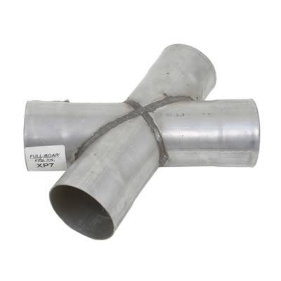

Some of the guys I know have bought a x-pipe piece and then have had the exhaust shop graft it into their exhaust system along with bigger pipes of course.
An example:
http://cgi.ebay.com/ebaymotors/Jone...ptZMotorsQ5fCarQ5fTruckQ5fPartsQ5fAccessories
If you are going to just be patching the stock exhaust I wouldn't do it. Save your money and get a whole new exhaust put in. X-Pipe, better mufflers, etc.
You can patch in parts using the existing tubing but make sure you remove resonators, along with better mufflers and the xpipe.
yea i just bought one off of summit racing and took it to by buddies garage and had him replace the third cat with it, probably very little performance gains, but it did make give a little deeper growl to the sound
