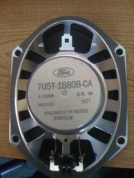

Ok, I bought the front passenger side speaker, it came in today, i got the factory speakers, so i got a 2000 LS Sport ..
Now before you see the pics, i looked at a members 2000 LS with the factory speakers, at the top there was a little one and the bottom, a big one .. The two front speakers have a tremendous amount of bass, now i asked some of you if they came with an amp, answer was no, now if you look closely, the watts says 25W, now how can 25W produce such a great amount of bass? I also orderd the back speaker, same side, 50W, with the bass in the front, i cant even hear the back speakers ( on the doors ) So anywho ..
Is this the right speaker Ford gave me? i even gave them the VIN # and everything, they said its the same speaker i have in the left side in the front, but i got that factory speaker image from that members front door and im confused .. Now, this speaker might be the right speaker but the previous owner must've installed an amp for the front, and dunno where he put it i guess ..

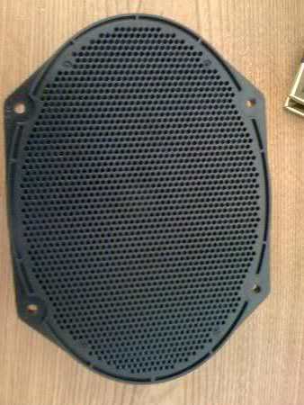

Pictures of orderd speaker ( Front Passenger )

That is a standard, non-audiophile speaker. They make bass like hell with barely any treble. If you had an audiophile system, those come in a plate setuip that fits a 5x7/6x8 hole, with around a 5 or 4" woofer and tweeter and midrange mounted in the plate, if I am not mistaken. I have a set of each speaker at home and am visualizing out of memory. That 5x7 they sold you has been used in everything. My son's SVT focus, my wife's marauder all have the same 5x7 "whizzer cone" speaker with a paper cone molded into it for simulated tweeter sounds. :-)
The 25 watts is max power and your radio makes all that bass with less than 5, most likely. It's all about the efficiency of those $2.00 speakers and running at 4 ohms impedance.

ok guys, i got it, its the right speaker, i snapped out that metal piece that covers the speaker, and its the same one.
