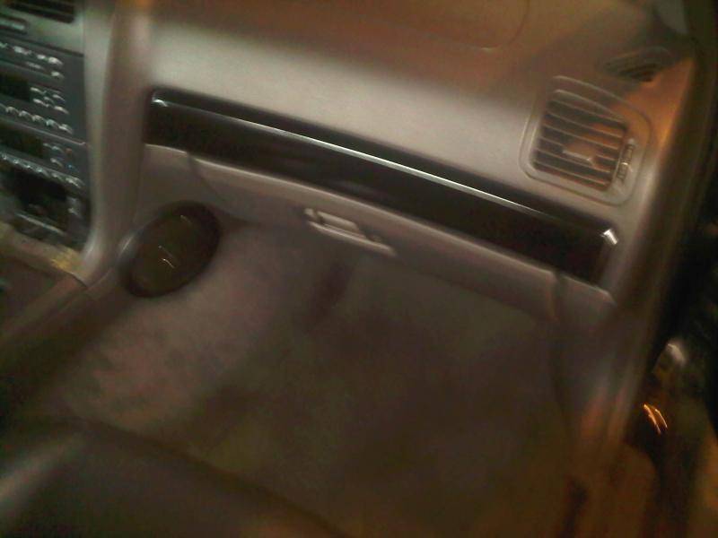

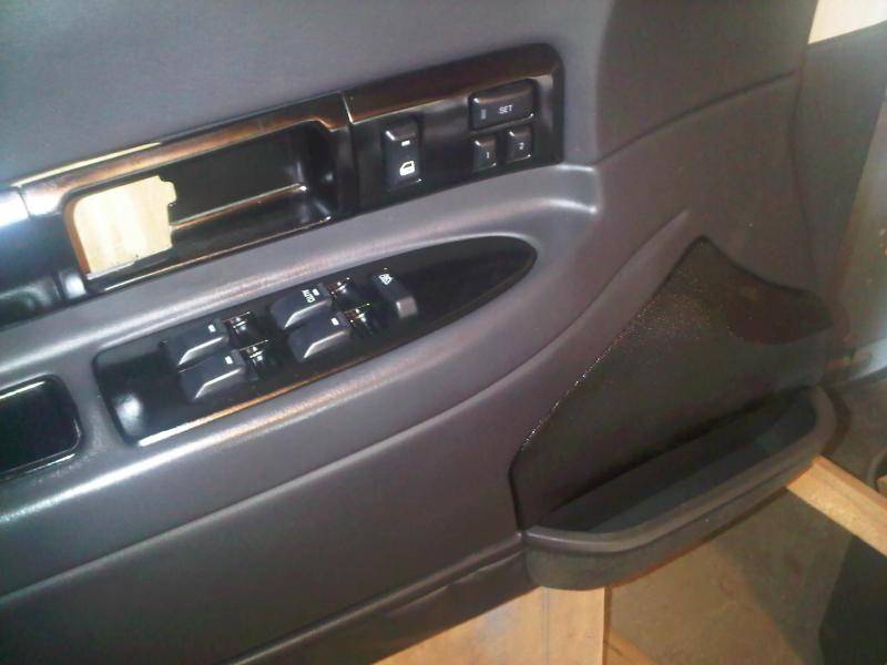

Not sure, but post pics of all the black trim for us after you figure it out please!
Okay guys, these are with the phone so bear with me. In two weeks I have a pro photgrapher coming to take pictures for me for LVC, Cardomain, and some car show sponsorship applications. So...here they are...sneak peak.

Looks tight! :) What kind of trim did you have in the LS originally? How much prep did you do before the paint?
Originally fake wood. For prep .... 2000 grit wet sand paper. Dry for 24 hours, then spray with promotion adhesive. It's a pclear primer to make stuff stick to plastic. Two coats dull black. 2000 grit wet sand ...two coats gloss black.
Again, bad picks, but the good ones will have there own post ina bout a week.
