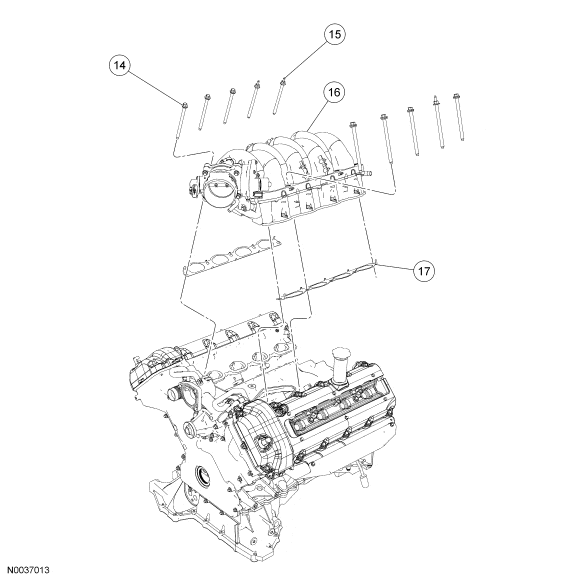

Can you identify the gasket(s) in question on this diagram?
The gaskets shown are about $18 each and very available. Not shown is where the plastic part of the manifold mates to the two lower metal parts. If it has come apart there, then the manifold has to be replaced. There are no gaskets to solve that problem.
The o-ring gasket between the intake and the throttle body is no longer available. I don't know if that one comes with a new manifold or not.
Anyway, the only thing that makes sense is that the manifold is broken where it meets the metal part(s) at the bottom. If so, everything they have done is reasonable. The last time, they may have tried some glue to seal it to see if they could save you the $1500. They may not have wronged you at all. BTW, the manifold is about $1200 and takes a couple of hours to change out.

Thank you LVC once again for you input. This has definitely been a trying time. The car was drivable and not really having too many issues besides slight hesitation when initially took it into Dealership to have the codes checked out. From the dealer I had it towed to avoid any more issues. At the new mechanic I was shown (according to the diagram listed above) where the two gaskets on the left toward the back had coolant fluid in them and the bolt #15 was rusty unlike the other bolts he says due to the coolant leaking on it. He also showed me where the #17 part look new liked it had been replaced. He stated the manifold is cracked and needs to be replaced. While there he pointed out several places where silicone was used on the engine, wires that were broken and repaired and some missing bolts. I should have pictures soon. Thank you
