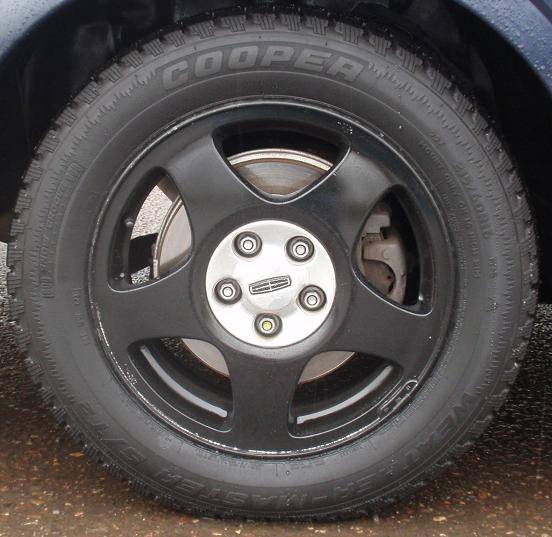

I have the stock 2001 16" rims with 215/60 Cooper Weather-Master S/T2 tires. I ran these tires last winter and had no real issues, felt very safe in the nasty stuff. I'm up here in Minnesota, and as most people know we don't have the best weather in the winter :) .
