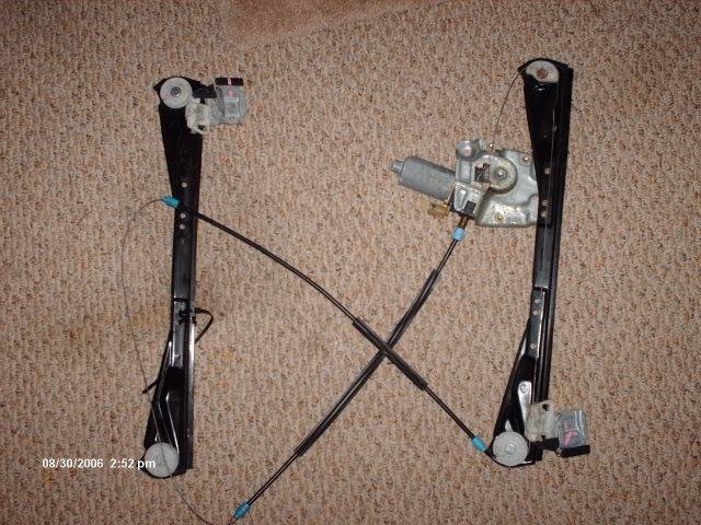

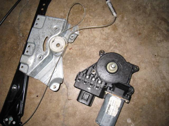

This may sound dumb but what is considered the regulator? The assembly has a left and right bracket/guide, pulley and wires, motor. On the pic below is the motor just the grey cylinder? And attached to that is the regulator? Is that whole grey deal in upper right the regulator? Confused? I can hear the motor move and the window will go try to go up maybe an inch or so but it reverses back down and gets hung up halfway. Made the usual crunch sound and then wont move.
The motor is the gray flattened cylinder. Everything else is the regulator. On gen II, the motor and gear are attached to the regulator with three screws. I can't tell from the picture if your gen I is the same.
That picture isnt of mine, pulled from anothers post.
This pic shows the "motor" and the regulator, that clears that up.

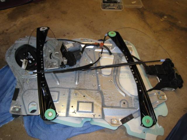

In This Pic what is the big black thing on the right? Is that attached somehow?
