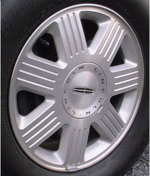

Secondly my mo-in law trashed one of my rims (don't ask, I don't know). Anyways, I can get my hands on a set of '04 aviator rims until i order new ones and was wondering if they fit?
I think they are same pattern, 5 boldt 4.25, 17x7.5
Sorry. I just did some research and tirerack.com says they are 5x114.
Ours are 5x108.
