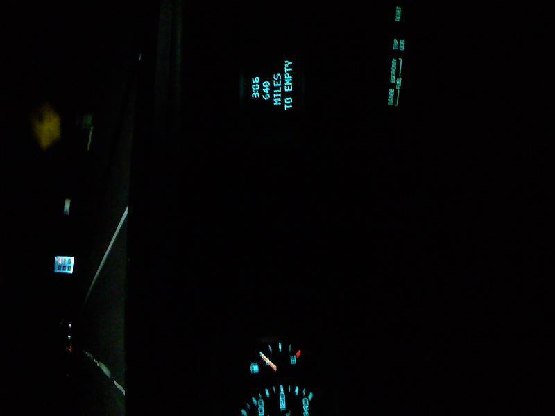

I'm getting better fuel economy now than I did before the motor was worked over.
Mods to the motor, sans some other stuff ya'll don't need to know about.
298 Stroker
Aeromotive Rails and regulator for the 98 Cobra
Cobra intake
75lbs/hr injectors.
3.73 Gears
Heavy foot.
And a Torque Converter issue where it locks up just fine, until you romp on it. Then, it stops locking up until you re-upload the tune.

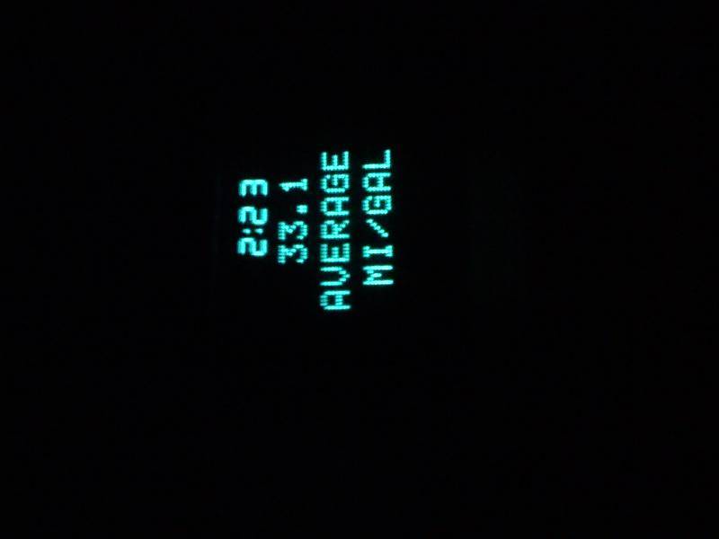

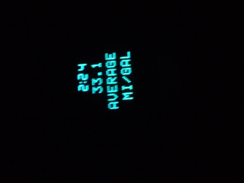

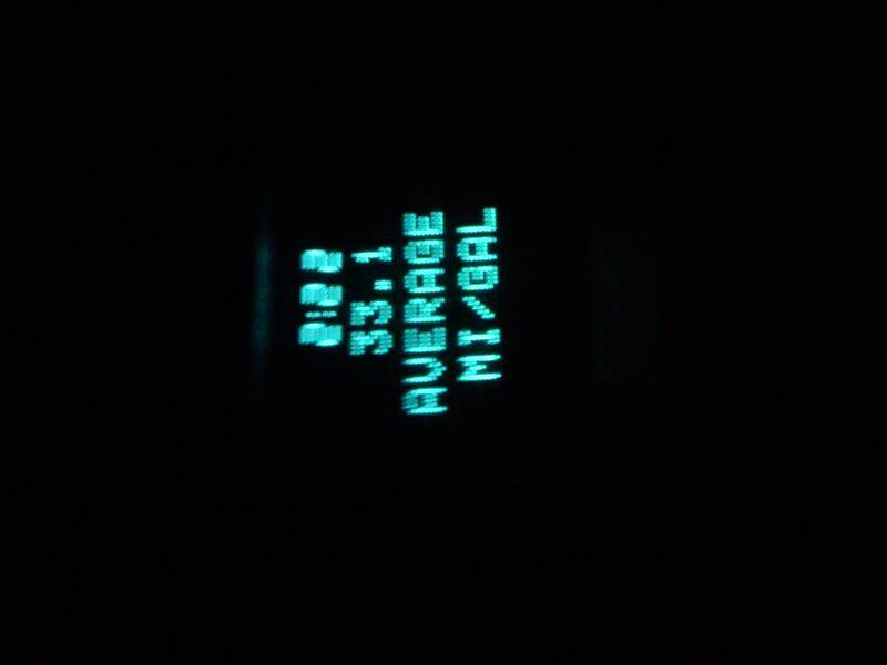

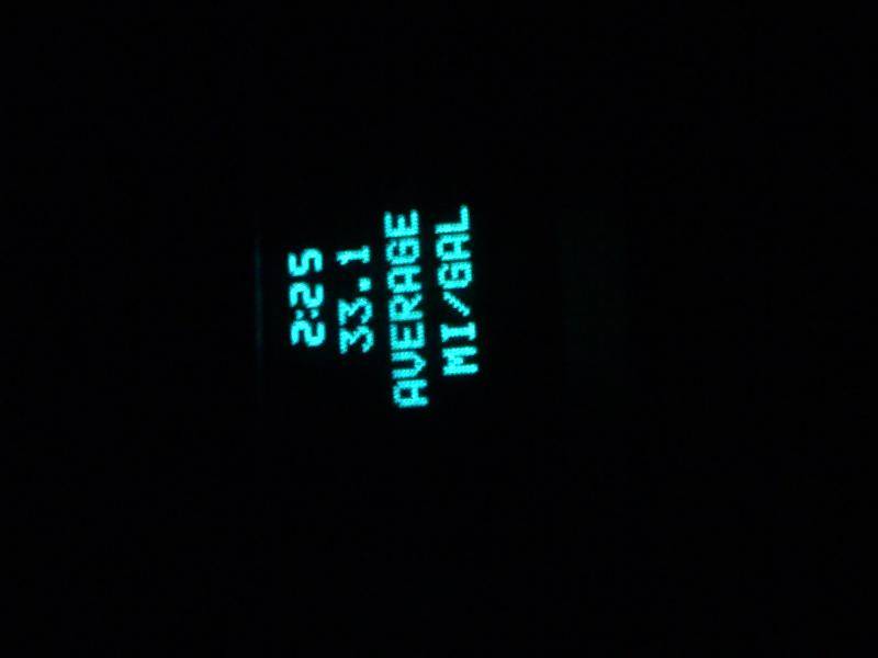

Took several pictures over the span of a few minutes, because there will always be the one guy who says "Awww, shucks! You just reset your average!" OK, Skippy. You reset your average economy and be that consistent.

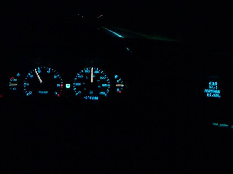

Yes, the speed is incorrect. With another 2000PM before the rev limiter kicks in, the motor was still pulling hard. That speedo was buried, and the car was still pulling.
