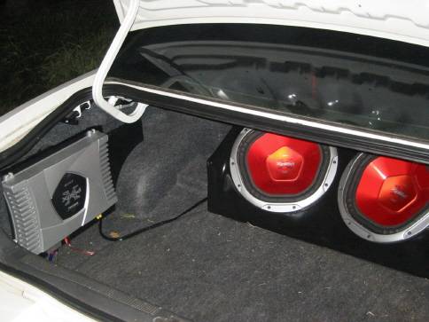

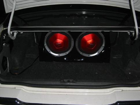

This is my current setup with 2 12" subs.
