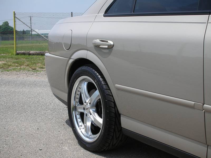

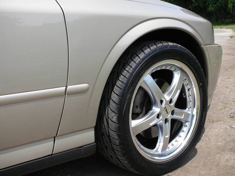

TSW jarama's 18x8.5 with 40+ (42 i think) offset.

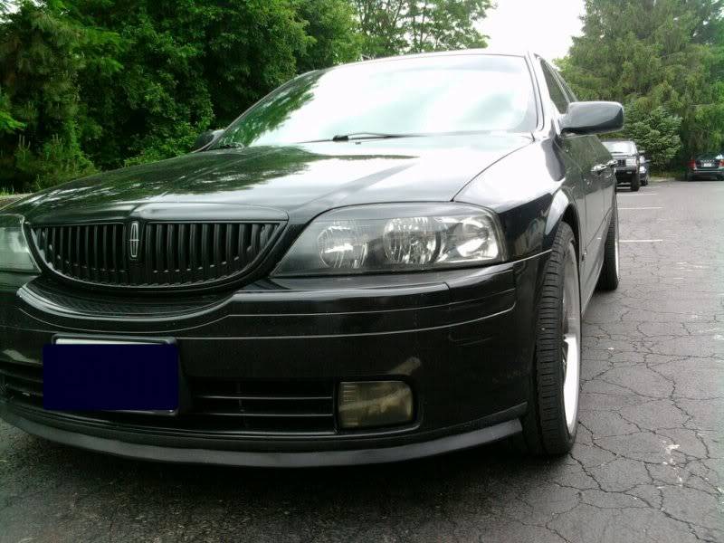

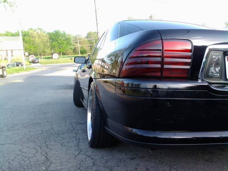

I'm running these on 8.5" Hankook V12's. The offset is +48mm, and they sit just inside the fender wells - perfect spot, IMO. Absolutely no rubbing in any conditions - full steering lock or going over speed bumps. I made sure that the heighth of the new wheels/tires was at or below the stock wheel/tire combo.
