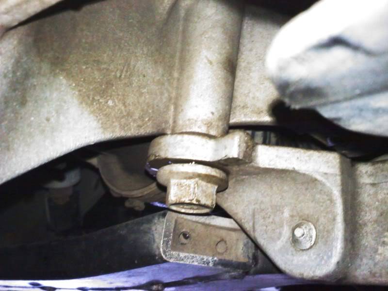

When I was checking out my shifter to see if a mustang shifter would work(which it will with modification) i noticed two loose bolts on the suspension. I took pictures of them and will load them later but I couldn't tighten them all the way so I don't know if they are supposed to be loose or not.
If you're talking those two bolts on the sub-frame connectors they are supposed to be "loose". They aren't loose, that's just the way they are supposed to be. That connector is actually for front-end crash protection. Early LSes don't have the connectors. IIRC, they were added sometime in the middle of the 2000 MY run.
...i noticed two loose bolts on the suspension. I took pictures of them and will load them later but I couldn't tighten them all the way so I don't know if they are supposed to be loose or not.
Don't screw those bolts in. You need to put them back the way they were!
I didn't even get half a turn out of them. There is still a gap between the connector and aluminum sub-frame or w/e. Here I'll get a picture in a minute to make sure we're talking about the same thing.

So those are for crashes and they do what? Why would you want them to remain loose?
They're not loose. That's just where the bolt seats. They are for front-end crash protection. I believe they keep the passenger compartment from collapsing.
