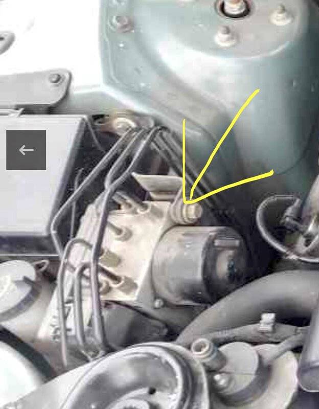

It's been bugging me that I can't find it in the service manual...It appears to have all the brake lines coming to it.
[and no! I don't mean the bolt or bracket...LOL!]

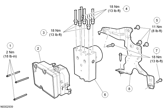

ItemPart NumberDescription
12M101Anti-lock brake system (ABS) module-to-HCU bolts (3 required)
22C219Anti-lock brake system (ABS) module
32C292Brake line nuts-to-HCU (M10) (3 required)
42C326Brake line nuts-to-HCU (M12) (3 required)
53B676HCU bracket-to-HCU bolts (3 required)
62C286HCU
72C348HCU bracket-to-body bolts (3 required)
82C304HCU bracket
