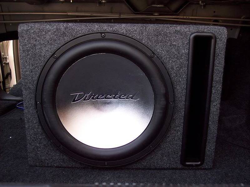

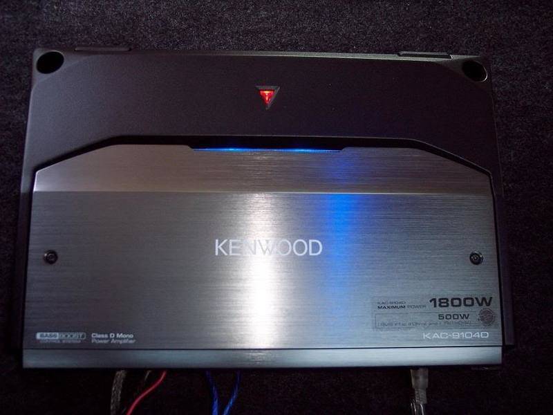

I have 1 12" sub in a vented enclosure, and I believe 900w going to it continuous.
This is the sub:
This is the amp:
