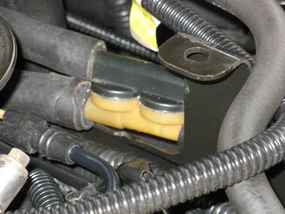

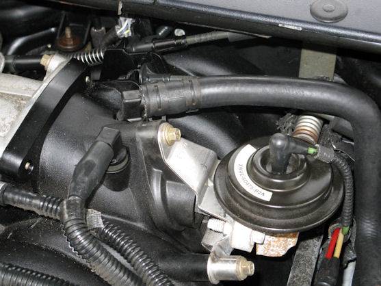

I found a cut hose,it is the bottom one that is connected to clear that goes in the top rear near throttle body,injection plenom,what is that hose for??
top pic bottom hose attached to the yellowish part of that diaphram thing,cut on hose near clamp,also loose on top where it connects to intake,
I think it is like a pcv hose without the valve,my understanding is the 2000 3.9 v8 dosent have a pcv like the v6,,maybe that yellowish thing is like a ckeck valve of some sort,i have alldata and cant find any info,but i wanna replace the hose when i find out what its called
not pcv
my v6 has the same thing, not sure what it is. but its not the PCV valve hose.
Its called a vacuum manifold,it is sold as a unit,it has 2 vacuum hoses attached to it and sells for about 40 bucks,
