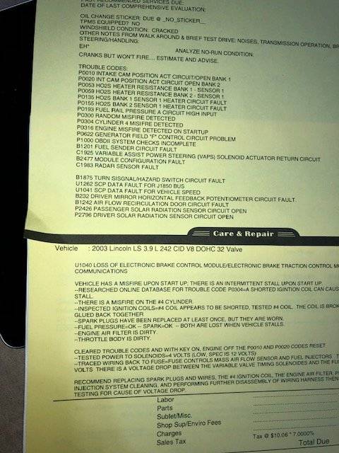

I'm having issues with my 2003 LS with the 3.9. It had been neglected for quite some time but had the basic maintenance done. Recently it had started running super rough and dying on me so I took it in to get checked out, they looked it over and the result was a phonebook of codes.:(
P0010, P0020, P0053, P0059, P0135, P0155, P0193, P0300, P0304, P0316, P0622, P1000, B1201, C1925, B2477, C1983, B1875, U1262, U1041, B232, B1242, P2426, P2796, U1040
So I put on a new throttle body, fuel sensor, coils, plugs, 02 Sensors. I cleared the codes and was able to get about 300 feet to the stop sign when failsafe mode kicked in. Then I had codes P0135, P0155, P2106 pop when I got back to my garage. Is the next step replacing my PCM?

Maybe, but probably not. Almost all of those codes have one thing in common, the engine wiring harness. Maybe some rodents got to it will it was sitting? They find the environmentally friendly insulation on the wires tasty.

Alright! Looks like I’ll be goin over the harness and hoping i find something.
