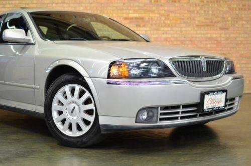

I'm thinking about buying this for the wife. Opinions? Problems to look out for?
2003 Lincoln LS Premium - LEATHER HEATED/COOLED SEATS SUNROOF WOOD | eBay
Mileage: 84,468

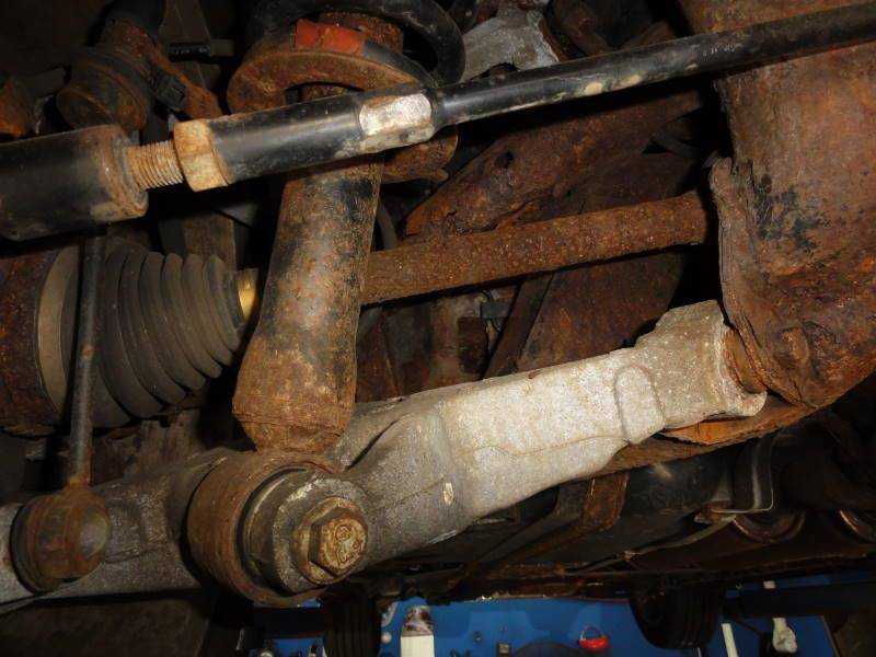

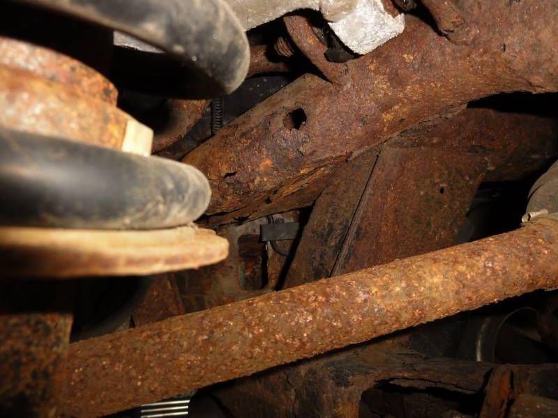

I would be reluctant to buy any car that comes from a 'salted road state' without seeing pictures of the underside. Here are a couple of pics of an LS that was subjected to salted roads.
Yeah get some photos of the rear frame mounts, the inside of the wheel wells (behind the plastic) and the rocker panels. The rear frame itself may be rotten too. If you see any tar or fiberglass RUN AWAY.
Assuming the underneath is fine, what are you planning to do with the car? The v6 is much better on fuel than the v8 (MUCH better), but the v8 is WAY more fun to drive. It's a huge difference. I own both, the v6 is still a great car but the low end torque on the v8 makes this car special.
I would be very weary of purchasing a car without seeing underneath it. I made that mistake with one LS and everything was rotten.
