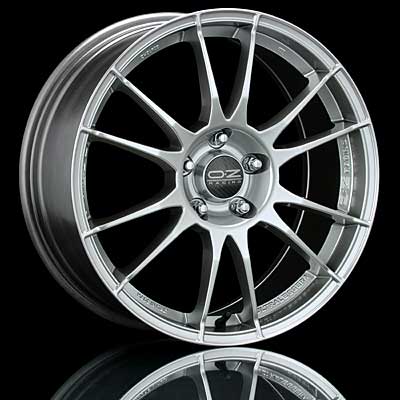

I found these on ebay and I am considering them. They are 5x110 but I could have them redrilled. How do you think they would look.

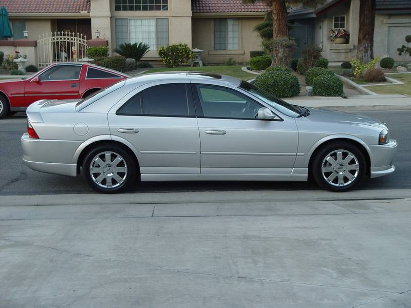

I think they would looks sharp. Did you get window tint tickets for the fronts and had to remove it or is that the look you went with?
thats how it was when I bought it. Still need to go get the fronts done. Its SUPER illegal where I live so, there are only a few people that do it. Anyone think the 50 offset would be a problem?
I suck at photoshop, but it's good practice. just a quickie.
lol can you see the little camera by the bottom right of each wheel.
I agree, they look good on there, but the stocks look good too, I love the look of your car.
If you buy them, I may be interested in purchasing your stocks depending on shipping costs etc, that is if you're looking to sell of course.
If I could get the stock wheels in 18's I would have it like that. But I REALLY dont think the 17's fit the car, especially with the body kit. My wheels should be up for sale soon :)
what do you guys think about tire size, I was thinking 245-45/18. I want the side wall pretty beefy, thats why I was thinking a 45. Anyone have any opinions on the 50 offset?
I run a 245/45-18 with a 48mm offset on a 1" drop with no problems.
This size tire is also the same diameter as the stock 235/50-17.
I love that style of wheel. It's very similar to my CDC's, but I am not a big fan of re-drilling wheels. It has to be done just right, or else you are in for a world of hurt. Not only does re-drilling weaken the hub, but if not done properly, it will cause vibration and balancing problems. I think it would be more cost effective for you to find a set of wheels in that style that already fit an LS.
Well here is the thing. The shop I use has an old ASANTI machine that they used to use for drilling. I have seen their work and I talked to them and they said 2mm is NOTHING compared to what they have done. Im going to go talk to them tomarrow.
