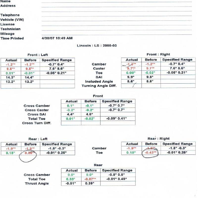

Lowered my LS w/Eibach this weekend. Also needed an alignment done due to replacing the rear subframe.
Anyhow, I know it's normal to not be able to get camber in spec but I didn't expect to have a caster problem??
