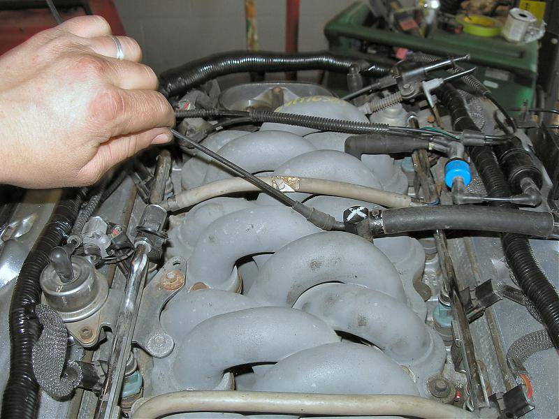

does anyone have a picture of this vac???
no need to yell. i thought XLRVIII explained it fine. heres a pic. this hose should run into your pass fender. inside your fender is a vac canister, i bet its bypassed, then into the heater control.
