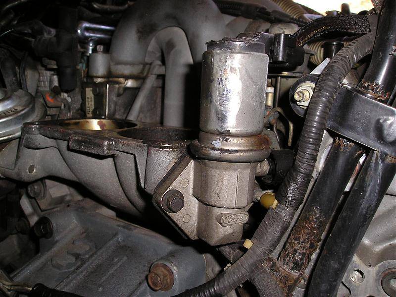

I had similar problems, and found out it was my TPS. but if it is your IAC spray fome fuel inj cleaner down there to free up the gunk, you dont want to replace it, it sucks to get to, I knew mine was bad but I waited for my transmission to go before I did it.
