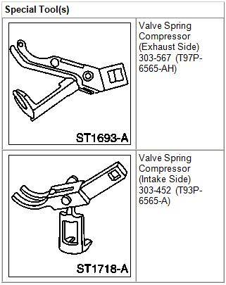

do any of you know were i can get ahold of the valve spring compressor. I tryed using the regular ones but it doesnt work. Im looking to buy a cheap one or rent or loan one
There are two Ford/Rotunda special tools required for the valve springs in the 4V engine. It took me quite some time to find both of these at a decent price. Cheap is not going to happen, sorry. :(

Once you see the prices on the two Rotunda tools you may change your mind... :D
man still to expensive for a one time use. Ima have to call the machine shop see how much they charge just to install the springs
