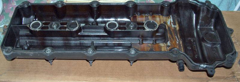

Here's some pics of the old cover... Oh, and inside looked a MESS. AutoRX here I come lol. The valvetrain looked immaculate on the car in the article compared to mine.
-Matt
