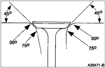

hey well im new to this group glad to be aboard. i was just wondering if any of you knew the degrees on the intake valve face and the seat as well as the exhaust.
Buy a Factory Service Manual. ;)

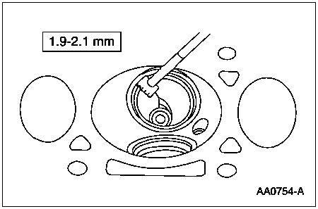

From my '98 manual.
