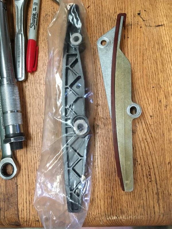

The replacement parts shown for this on every timing chain kit I can find on the net show a radically different part. Here's photo of mine and it's 'replacement' side by side. Even though the picture stinks u can see the part is different and would never install with the correct orientation.
So what is special about my engine? And where can I find this one chain guide??? I am going to talk to dealer parts tomorrow but IME once they see 'discontinued' they frown and say no can do.
I wonder if the parts you are finding are for the FWD version of the engine? That version would be much more common. Maybe you should try some Jaguar forums?
Lists of compatible engines for these kits contain the LS as well as a number of FWD appliances. Unless I'm mistaken the Jags had vvti from day 1 so will be diff under the timing cover. I have looked at Terry's jaguar and they have almost nothing avail in the timing area. Rockauto says vvti so Jag is out.
The part number is 6K297B. In the drawing in fordparts .com (see below) the part can be seen and it matches the one I have. There is also a 6K297A for the RH guide.
I took your advice and looked up the 3.0L in the 2001 Escape. The part there looks exactly like the part that is in all the kits. (below) And the part number is the same except for the B modifier. 6K297 What's even crazier is there's another 6K297 in the escape parts list and it is entirely different!

Yes I looked there last night and it's all V8s. I also emailed Guerra International who says 'if u cant find it we will' or something like that. They answered back this AM - 'no stock anywhere.'
It looks like I have no choice but to put that used piece back in with the knowledge that if it ever melts down from use it will mean the engine cannot be repaired. Ford has really lost me on this one. :(
