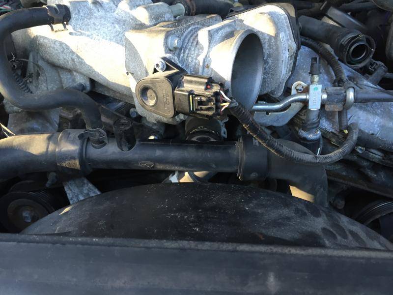

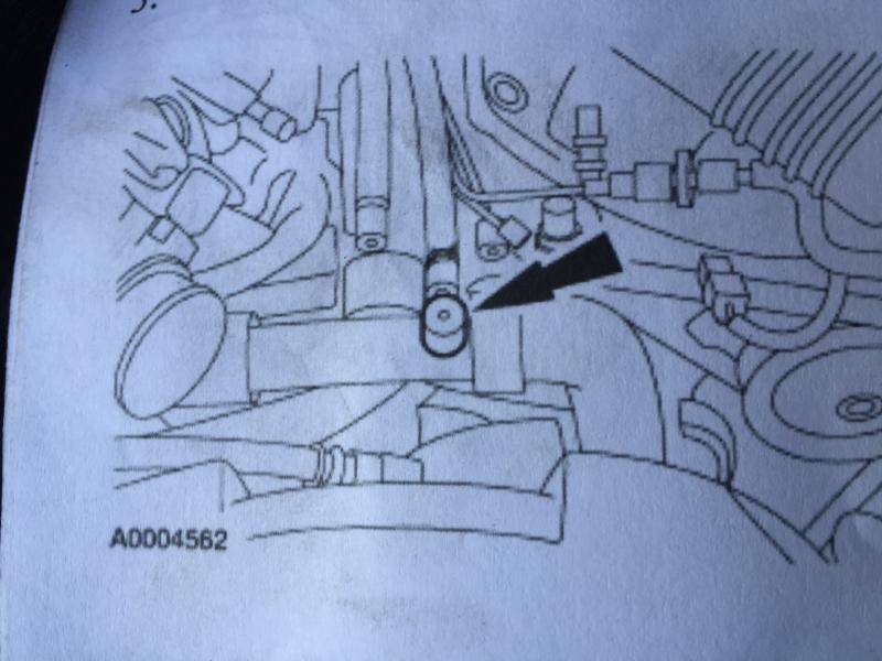

So I am guessing that the Engine air bleed is just further to the left on my 2004 LS than in the diagrams ? I am surprised there is not a hose coming out right at that bleed though.
That bleed does not do anything, it does not seem to open. Does that hose need to be replaced?
thanks

Hmm Stumpy, it just spun freely.. Does this mean it was already cracked in there?
