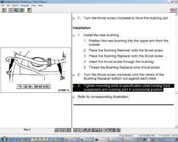

Question 2: How do you use a torque wrench to tighten to the listed foot pounds? (same way as the LCA's - with the car on the ground? See below for what the manual states)
Can't see my socket and torque wrench fitting in those spots on either side. (master cylinder, and A/C accumulator on the other side) .I had same issue trying to torque the LCA cam bolts with the Rack in the way. I think the cam bolts should be inserted bolt from the front (by the rack) to the rear of vehicle, then they could be torqued easily. I would think you just switch sides and the cam bolt would work the same. I'm going to ask my wheel alignment guy when I'm done.
Below is what the Ford manual states:
"Tighten mounting bolts to specification while holding front suspension arm bushing joint in a horizontal position". Not sure what they mean by this. Not like you would hold it vertical.
