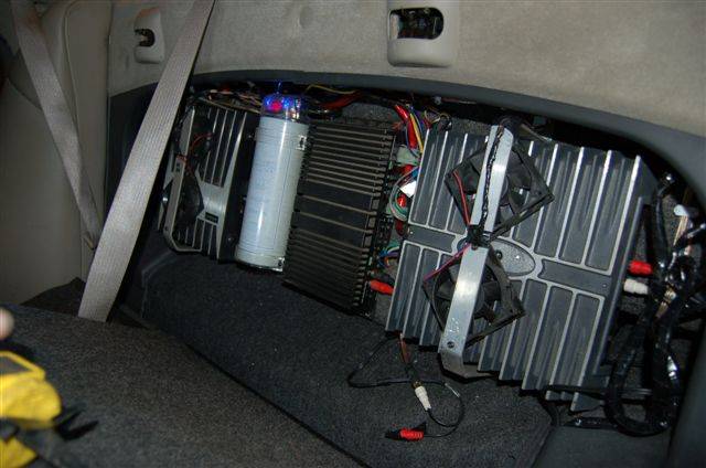

a capacitor goes inline between your fuse and your amp. so the setup would be battery fuse capacitor then amp. they also need to be grounded like your battery and amp.
the easiest way to do it is to put the cap near the amp. run both power and ground to the cap, and then run both power and ground from the cap to the amp. done simple parallel circuit.
I use mine as a terminal block for the 3 amps I have in the back

Actually I have an "old school" setup with 4 amps.
1. Rockford 1000 watt rms mono amp for subs.
2. Rockford 500 watt rms for the 4 door speakers-mids.
3. Alpine 200 watts rms for coneless Bass Shakers under front seats.
4. Soundstorm 100 watts rms for tweeters behind glovebox.

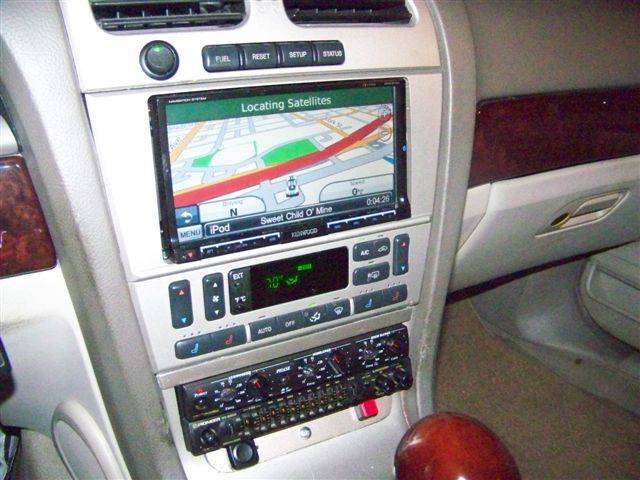

Also have
Kenwood 6042a 1/2 din EQ w +-12db and
Kenwood KEC 202 1/2 din 3 way crossover
where the ashtray used to be.
so I can control the overall EQ as well as the EQ and gain on all 4 amps from the dash.

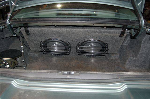

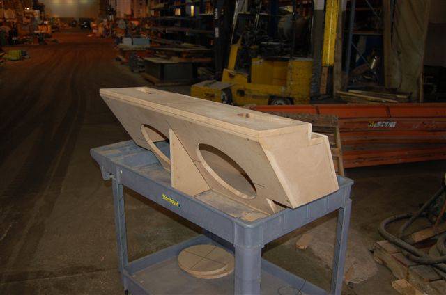

You should build a box like mine.
3.7 cu ft with very little lost trunk space.

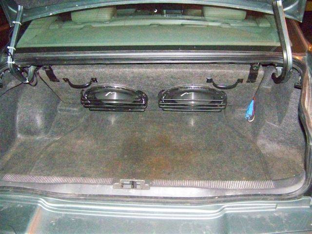

This box leaves lots of trunk room.
You could probably mount 15's in it.
that would leave a lot of room but it wouldn't hit as hard as it could because it wouldn't be to the specs for the L7s.
