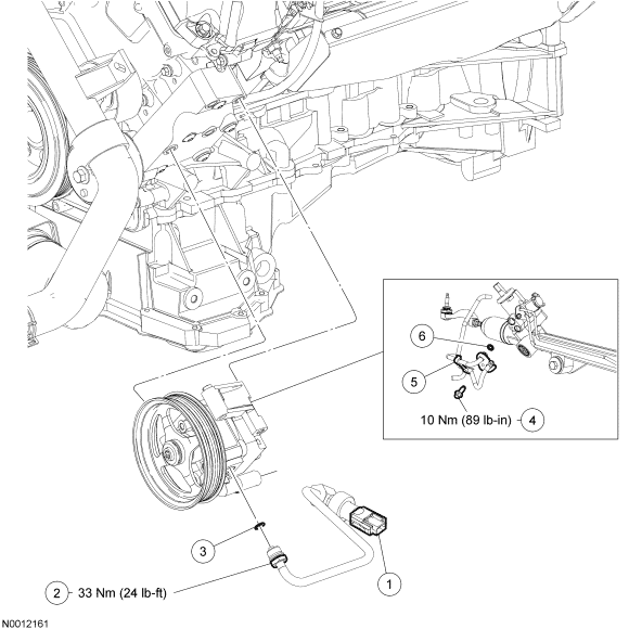

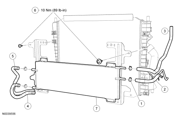

That is a dual cooler assembly.* There is a circuit in it for the transmission, and there is another circuit for the power steering. It's a power steering leak. The common leak point for the power steering is the high pressure switch, usually in the middle of the high pressure line.
(*: Note that the 1st gen used a tri-cooler assembly with circuits for the transmission, the power steering, and the hydraulic fan.)
13C750Hose clamp (4 required)
23A713Steering gear-to-cooler hose
33493Cooler-to-reservoir return hose
47A030Lower transmission cooler line
57A031AUpper transmission cooler line
6N811810Cooler-to-radiator bolts (2 required)
73F749Power steering fluid cooler
1Power steering pressure (PSP) switch electrical connector (part of 14401)
Just a note that on my 2003 LS Sport that PS electrical switch was leaking thru the switch itself. I had a hard time just getting the switch as there also seems to be an assembly to that has the metal tubing along with the switch.
Here is a thread with pictures of 2006 that might help?
PS Pressure Switch
Our resident LS expert joegr posted part number F3TZ-3N824-A was the switch in that thread.
