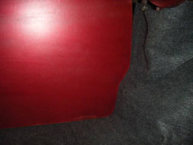

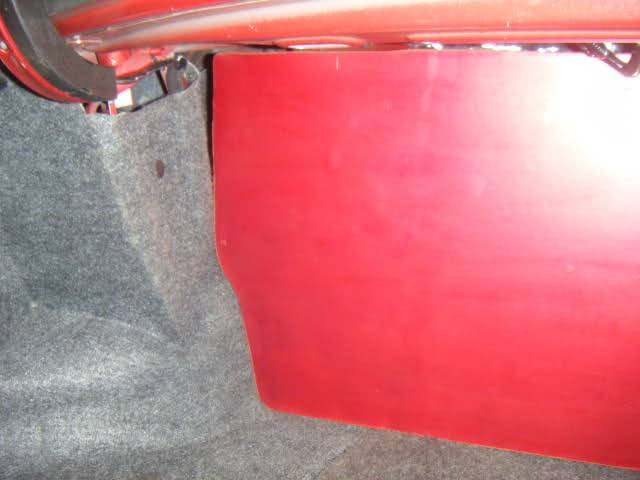

Took about 35 min to make and fine trim for the best fitment. Secured by 2 strips of velcro to the box.Didn't even really need it.The space on the upper corners are straight but the carpet ended. Once i get some cash i'll wrap it in trunk carpet or black carpet. All i used is whatever i had left of some duplicolor paint that was close to the oem color..Didnt want to waste my good t.red.
It is covering my upwards facing box(blowthrough) and the amp rack that is mounted to the rear seat braces. I have my amp,oem amp and loc mounted on it.
its darker in person..But i do plan on getting trunk carpet or black paint/carpet when i free up some money..I got bored so i figured why not make a panel. That and i just got done theft proofing my box and amp rack.

thanks..I think you guys overlook the fact that it is getting carpeted. Its not staying that way..Perhaps i should've waited till it was done..I was just happy that it came out the way it did. Thought i was gunna have to cut multiple panels to get the right fit...Keyword: If you want it perfectly shaped make it abit oversized and cut a little off at a time..I must've test fitted/cut it 12 times till all the lines matched up.

where i cut mine i measured the widest point first wich was 43" which was at the top..The bottom was 38" at a height of 14 3/4". Then just slowly cut to fit the contours of the bottom corners/sides little by little.
