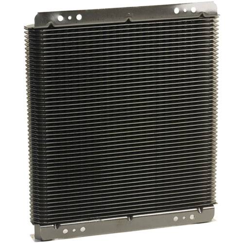

Who's using a stand alone Trans Cooler?
Think this is big enough for a stand alone?
How big is it/size tube etc? It doesn't look very big and is a less efficient tube and fin, a stacked plate design would be much better. That looks like it would make a decent PS cooler though...

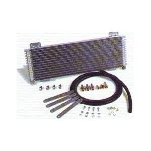

Tru-Cool LPD47391 (45,000 BTU)

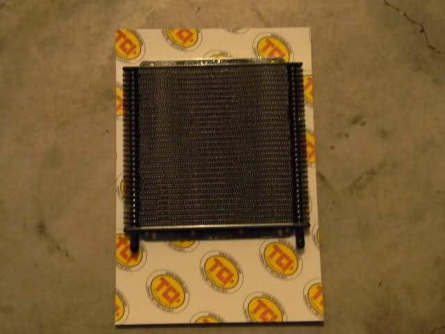

TCI Max-Cool 824104
I have a Tru-Cool 29,000 BTU with my stall in the GTO. Trans temps are at 130-150f on the highway and the highest they ever got was when I was smashing on the backroads in 2nd gear. It got up to 190f... I also use Redline ATF which helps a lot.
