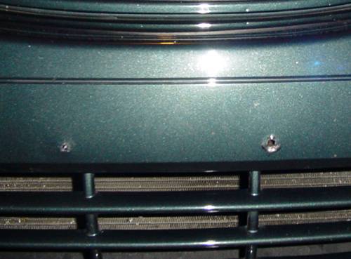

I had an hour before I had to leave home for an interview, so I decided to remove my front license plate frame.

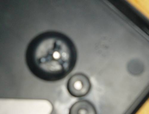

I drilled through the center of the driver side rivit, and then pulled a little. Then I wanted to cry. I didn't remove the rivit correctly and made a nasty hole in the bumper. I was able to remove the next one correctly, however I still have one nasty hole.
I think that I read that you can order painted bumper hole covers for $25. I might do this, or put the license plate frame back on the hide the ugly hole.
I have included pictures of my mistake so that others hopefully don't do the same. The trick is to remove the entire head of the rivit before you do any pulling on the frame.

Get the bumper hole covers if you don't need the front license plate frame.
you know if you have some touch up paint and a kragen auto parts or advance auto you can fix that for about 2 bucks. I took off my front license plate went down and bought some black plastic plugs cleaned up the holes with a razor blade, painted the heads of the plugs with touch up paint, then inserted them. Put another coat on the plugs and finished. Took 10 minutes at the most and little to know money. The problem I found with the plugs on the interent is they want you to drill out the holes on your bumper bigger. I did'nt want to do that so I did my own. Just an idea.

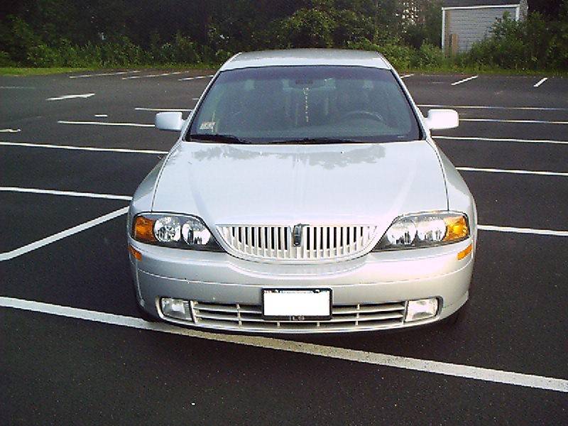

thats to bad,, taking my front license frame off was pretty simple don't knwo why u were drilling anythin.
replaced it with a crome frame that is alot more flush and a better look with the grille.
would look even better if i lifted it, so there was no bottom over hang,, but didn't want to drill new holes, so i used stock holes and lifted frame high as could go.
