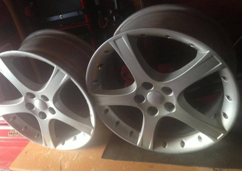

heres a pic of the wheels! I got them off Ebay from a guy that lives near me for $255 wheels and tires. i want to do them black but im not sure to do a flat or gloss black :/
And i think i will just use the tires that came with them for this summer since they still have some good tread left on them. These are going to be my summer wheels anyway and i will prolly just wait and get some new rubber next spring and maybe i can do 245s in the rear and 235s up front for a bit of stagger :P
dude that was the box they were in!! ebay they went for $255! dang lol o well not much i can do now, but he did give me the tires for free!
