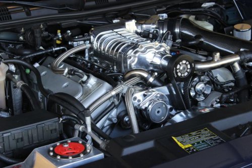

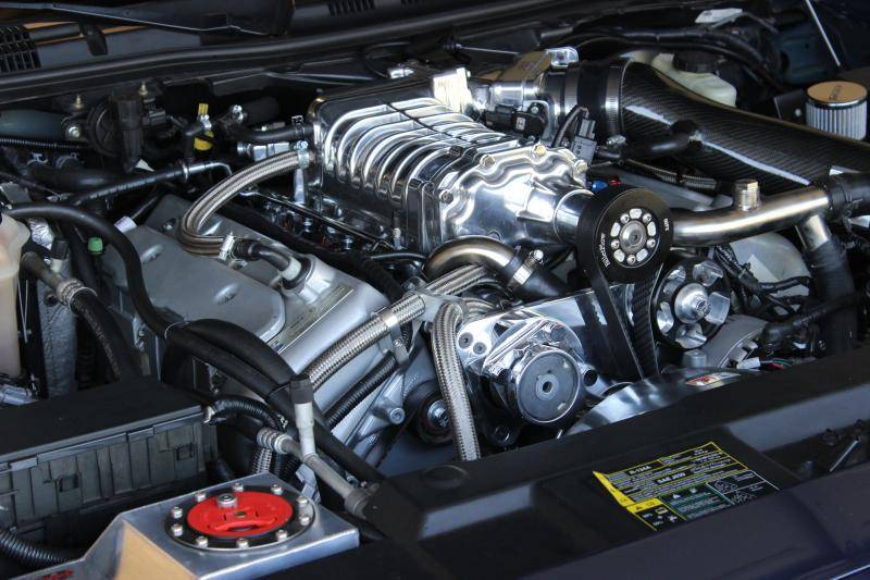

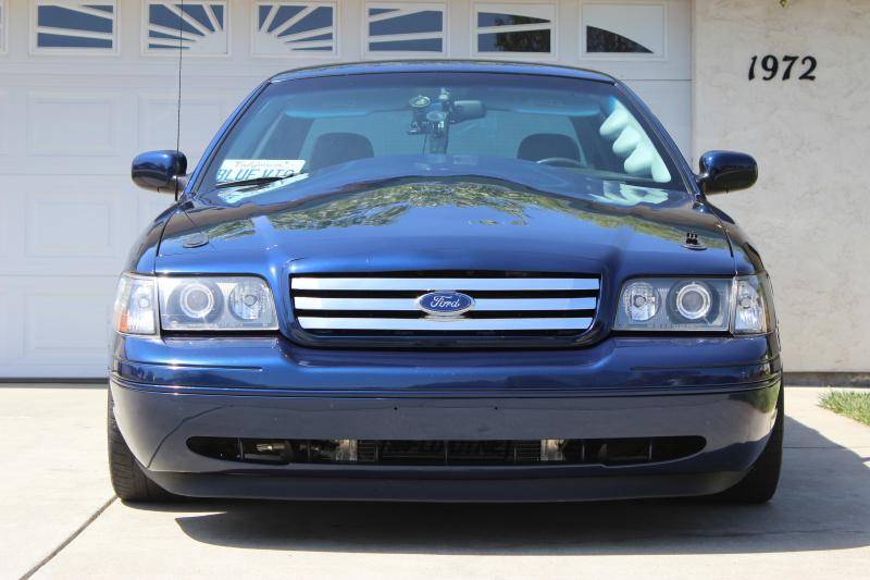

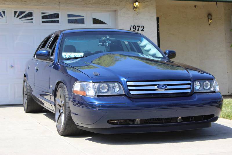

Here's some shots of the Vic.
That's awesome. I need it.
I couldn't help but notice under the bumper... And at the risk of adding parts to modify your DD (though no one has done it to Gen 2s yet)... Mach chin spoiler
damn that is sure a mean Vic!
is that an SVT tag on the motor??? do you have a terminator block in there? and what blower is that? looks like some real nice work was done to her!
I dont think the mach spoiler will line up right to a 06 bumper
Just needs the right application of a cutting tool... and a couple hundred dollars locked up in case you mess up
The only thing I noticed with my bumper is below the round fogs, there is an area that is not flat, it curves up at an angle.. I don't know how the Mach 1 chin spoiler will work in that area because it wont sit flush to the bumper..?
I adapted the same spoiler to work with my vic, so I'm well versed in cutting and pioneering stiff to work haha. I'd love to try it on my LS... Just those non-flush areas below the fogs worry me.
Terminator long block/cams with an Eaton M122 ported and polished GT500 supercharger. Stock blower pullies. It has a lower compression setup for safety (8:1) its at 10 PSI and pushing 417 rwhp/437 rwtq. I need to build my trans before I can add more boost. :) It still has the stock 4 speed auto in it LOL
