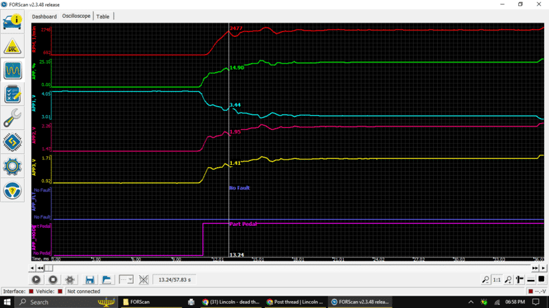

I have replaced the throttle body, throttle pedal, throttle sensor in my 2003 LS 3.9. Due to engine cutoffs and bucking leaving me stranded several times. It seems to be running well, but using Forescan I get the following,"Code: P0221 - Throttle Position Switch B Circuit Range/Performance". There is some other information such as bent throttle linkage, Mis-adjusted throttle stop.Corrupt RATCH stored in the KAM, SIGRTN open circuit, SIGRTN shorted to VPWR or ground. I could also offer my own colorful language to this perdicament, but I shall stay the straight and narrow course. The throttle body and the throttle were taken from a doner 2004 LS 3.9.. I'm wondering should I reset the PCM, or let it just run and re-learn my driving habits. Enclosed with the truest of Christmas wishes is a graph of the throttle system engine of course running. Any help will be much appreciated. Merry Christmas to all!

I would like to ask about the possibility of the VCT sensor being open at idle when they should be closed? I saw a Ford You Tube video about this. Below graph shows mine OPEN the whole time. Any thoughts on this? Thank You
