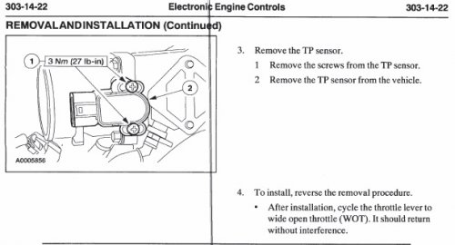

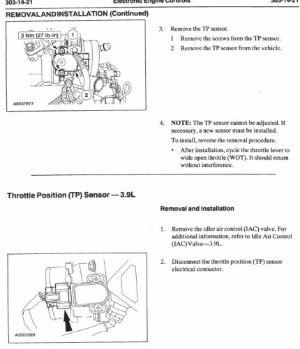

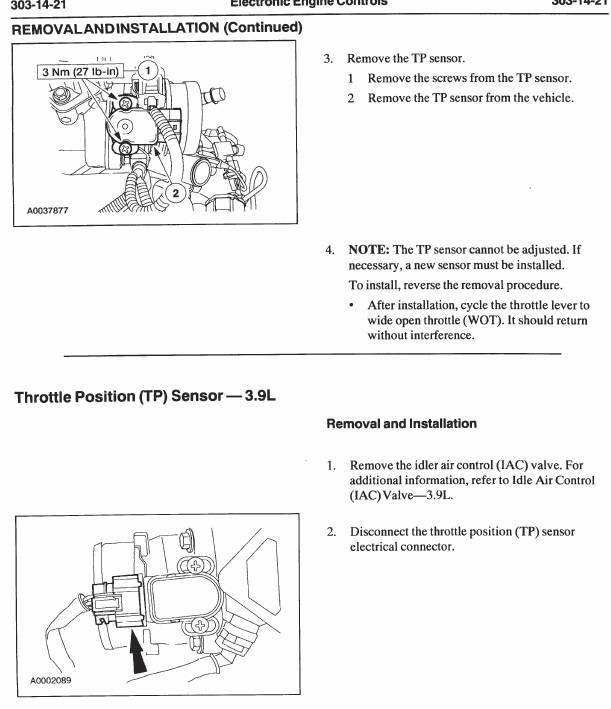

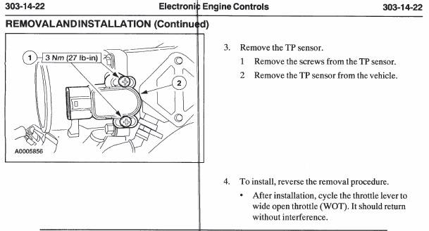

Not so according to the factory service manual.
I just tightened it up per the instructions ( thanks Joegr )
And she seems to be a bit more responsive, and idle a lot better.
