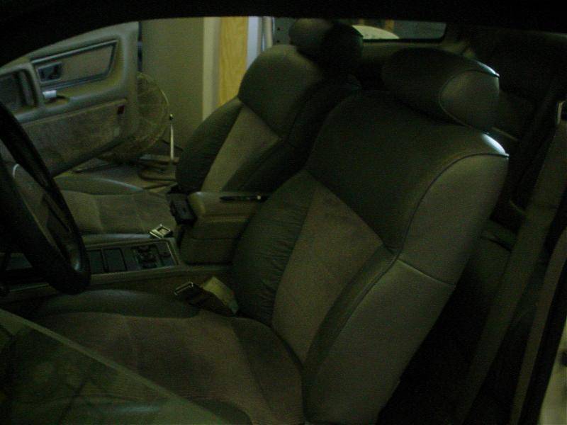

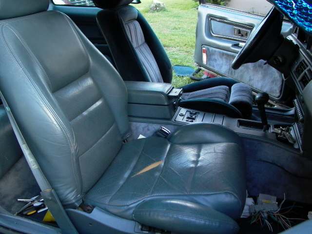

My latest Mark VII was a '91. The LSC seats, this year, were poorly designed compared to the ones in your car. Here's what I did...
The seat in the 87-88 T-Bird Turbo coupes were some of the most comfortable Ford sport seats...and that's what I got.
They even came with power lumbar and it plugged right up. But the thigh bolsters are manual-dial, like the mustangs (they work great). Further, they have that awesome pull-out extension in the front of the seat that the Marks didn't have.
The seats I got are heavy velour fabric that will last the life of the car.
They really look great in the Mark VII and are very comfortable.
Here's a couple pics for you... Hope this helps.
1 pic is the Mark VII leather vs the T-Bird seat and 2nd pic is Both T-Bird seats installed. I really like them in the Mark VII.

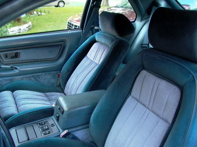

Heres how they came out. Finally made adaptor brakets to move the mountings over an inch and a half. 50 bucks for the seats, 3 hours in the machine shop to make the brackets. Not perfect but OK for now.
