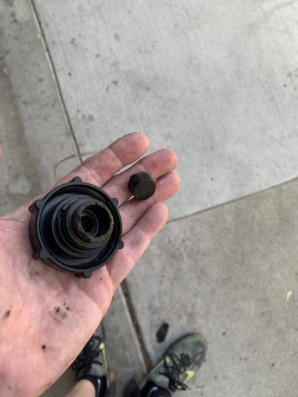

Now I have coolant coming out of the little hole on the drivers side of the thermostat housing. Is this a housing issue or an issue with the cap?
Yes, everything has been replaced in the last 5 years with Motorcraft parts.
Pretty sure it’s the cap…
Might wanna take a look at the thermostat.
